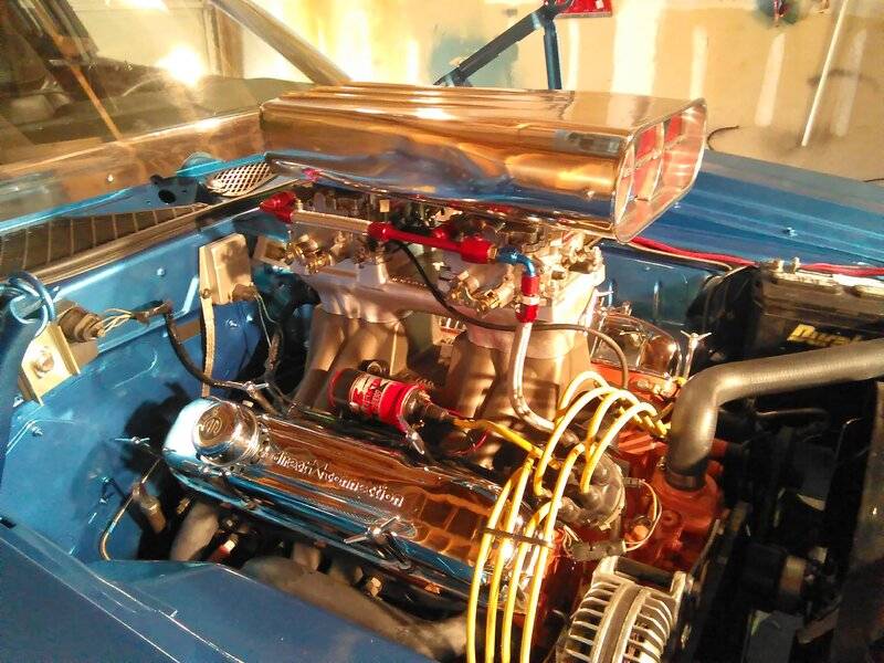

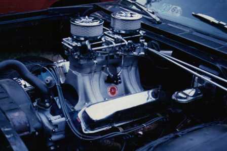

this is on a basically stock 440 , with the cam being a tad bigger. I'm using two 600 Edelbrock 1406's with the chokes removed , and set up to run together instead of progressive linkage. I fabbed the throttle cable bracket and the kickdown linkage. it runs very well with 355 gears
this is on a basically stock 440 , with the cam being a tad bigger. I'm using two 600 Edelbrock 1406's with the chokes removed , and set up to run together instead of progressive linkage. I fabbed the throttle cable bracket and the kickdown linkage. it runs very well with 355 gearsView attachment 1000867
Don't tell the naysayers that... It can't possibly work.....
One tip, try locking out the timing, no advance mechanical or vacuum, just set it at 36-38 degrees & lock it.... You may have trouble cranking it over, if you do there area couple easy fixes, either a retard switch or a ignition kill switch to disable the ignition when you first start to spin the engine, once it's spinning flip the switch & it'll fire immediately..
Also don't make the mistake of trying to run a single 4bbl... dual carbswork much better on tunnel rams..
Dual fuel injection throttle bodies would probably work for you too.

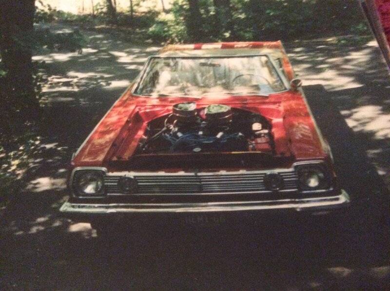

It is more doable than you would think. Back in the 90's, a friend of mine had a Chevy II pro-street car. Nice car, ran pretty good. One day he shows up with a tunnel ram on it. He bought one from a guy who had it on a show car. I told him he was crazy, it was going to be a total dog on the street. He gave me a ride and man what a surprise THAT was. It was incredible. Anyway, I figured, if he can do it, I certainly can. I had acquired the T ram and had most of the other stuff already from some horse trading I had done. I had never considered actually using the intake, it was just cool looking in my shop. I put it on my 65 Fury and it was a blast to drive. Mild 440, Crane cam that is just a little hotter than a factory Road Runner cam. Auto trans w/3000 stall converter and 3.91 gears in the rear. I used a pair of 600 vac secondary Holley carbs mounted in line. The key to using the Holley carbs is to play around with the accelerator pumps and get that right. I think I ended up with #31 squirters and used the 'pink' cam. Also, I have a manual valve body in the trans, no kickdown linkage to worry about. I made my own throttle linkage using an extra long throttle cable (72 Dodge pickup slant six application).
That thing ran great on the street. I did not expect that when I put it on. This car was my daily driver in the early 90's. If you lived in Virginia Beach in then, you may have seen it on the roads there. I have moved from there some years ago, but I still have the tunnel ram on the car and it's still fun to drive.
