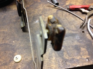

Well I finally took apart my window glass and regulator and these are the pics and what I found. Notice, on the 73 RR regulators I have rollers not slides. Where do I find these?

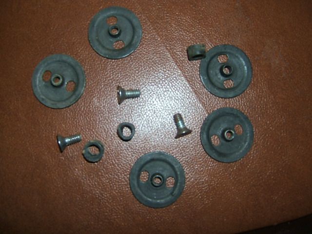

Also, where do I find new hardware to install the slide hardware to the glass itself. I have never seen these parts anywhere and have been looking for a while now. R/T specs might have the rollers, I will know Monday. I sent him the same pics and he is going to look and see if he can find something. If not, I will have to McGyver something. Thanks for looking.

Hey Dennis, check with a local windshield install company for the plastic parts to hold the mechanism to the glass. Believe it or not, I went to the local Safelite here, and the guy just gave me what they had left in stock because they never use them anymore.
One other thing, looks like your stops are rusty on the back side. You can re-use them just soak in de-rusting solution, clean and paint. You can get a new rubber gasket at a local hardware store, Ace is where I went for those, should be able to find a standard size that fits those.

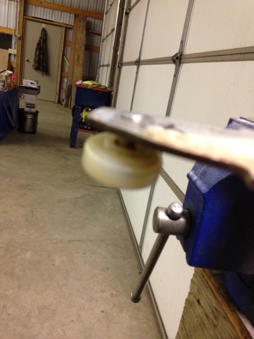

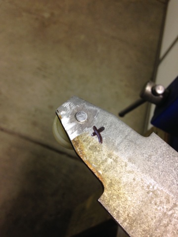

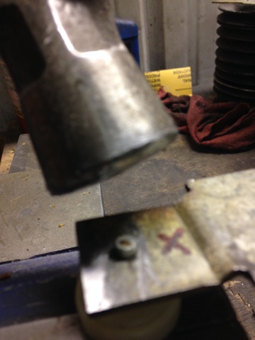

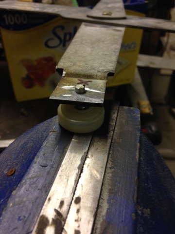

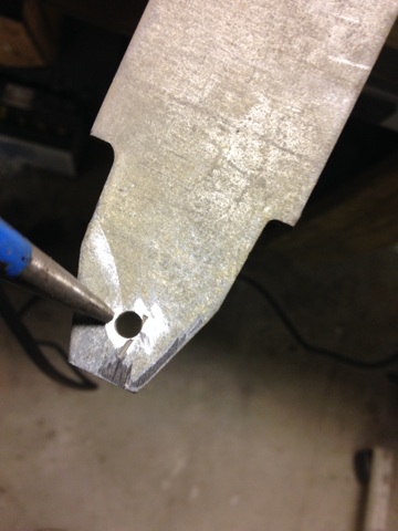

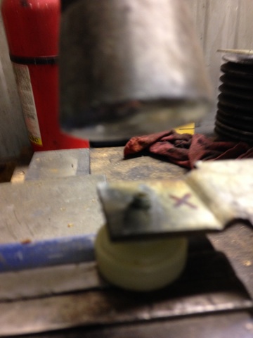

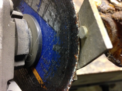

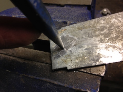

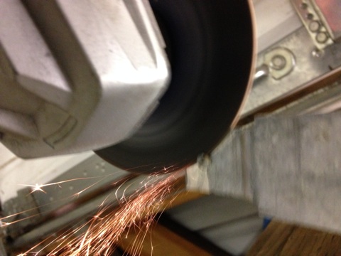

Here is what I did to remove and install the slides:
Here is the 71-72 square slide
I took a grinder
Ground off the end sticking out
found the stud
With a hammer, punched it out
Put the new round slide in
Hammered the stud until round slide was tight and stud was almost flat
End product.
At this point I did all 6 rollers and squares...changed them to the round rollers and
then installed them into the doors.
