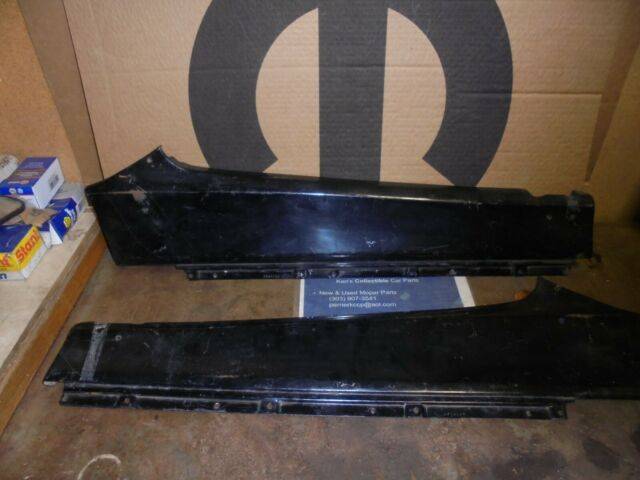

Ok, mystery solved... My thinking was all wrong. The felts were indeed stapled on the 68 Coronet. When I said there were no holes in the inside sheet metal of my car, I was forgetting that the inner felts weren't attached there. They were stapled to the trim panel, which mounts to that inner sheet metal. THIS trim panel:
So, my memory failed me again. Dang, it suck getting older! Thanks for all the input fellas.
