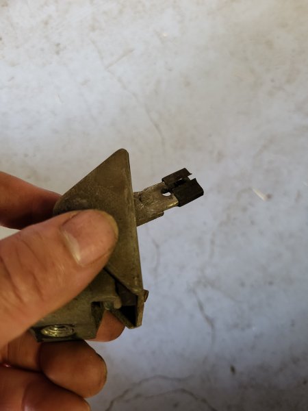

Once unbolted it should pull right out of the door.

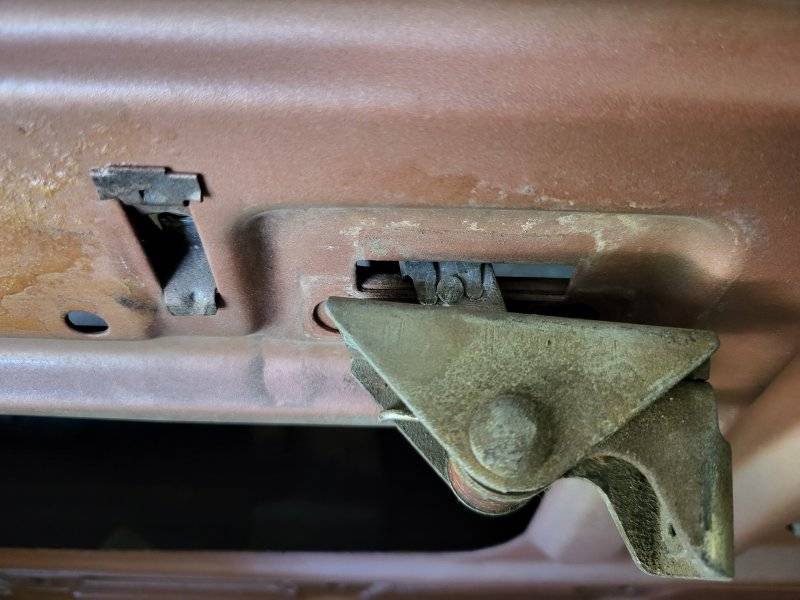

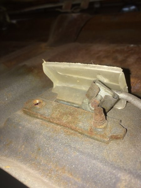

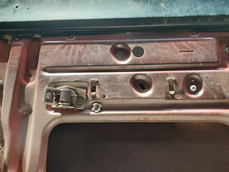

This is what the clip looks like on my 67. I was able to pull the mechanism out far enough to pop the clip off. Otherwise you're working blind inside the door.
One side was on upside down. I think it's the one pictured above.
Sorry Davek, I thought you had the latch off the rod.

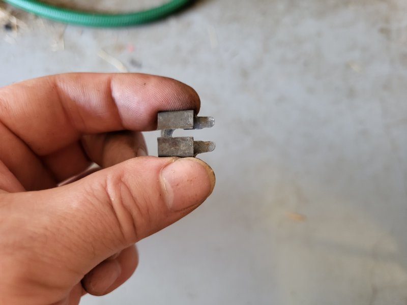

Clip pulls out and the rod comes off. Take photos while you're doing all this !!
