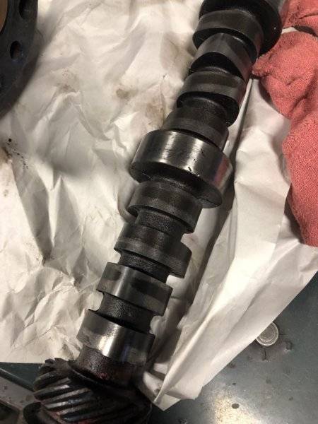

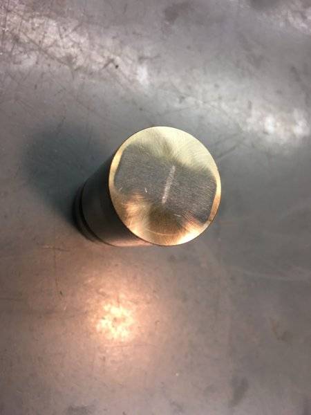

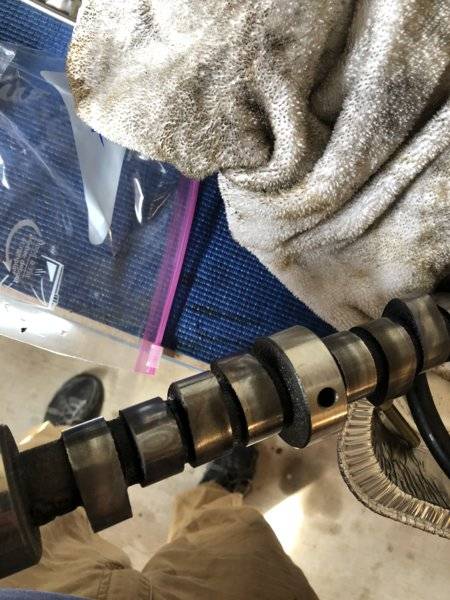

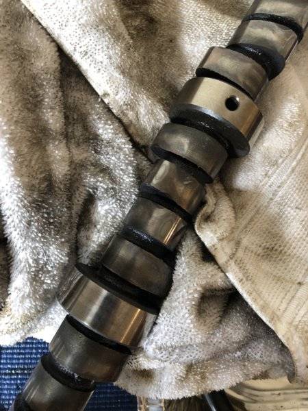

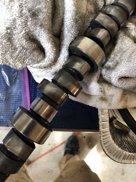

Edelbrock Rpm cam after disassemble.
Tried to show a bunch of lobe ends.
I’m not optimistic.
Input please.

Hard to tell from the pics, but the wear widens out at the tip of the lobe. If any lobes are losing metal, that is bad. Measure the exhaust lobes base circle to nose and compare then do the same for the intakes. If there a any large variations, the cam is worn. The better indication would be the lifter bottoms. If they are concave or damaged, replace it all. At this point, it is less to replace it now, than having to go back in in a month.
Hard to tell from the pics, but the wear widens out at the tip of the lobe. The better indication would be the lifter bottoms. If they are concave or damaged, replace it all. At this point, it is less to replace it now, than having to go back in in a month.
I thought they are supposed to be slightly concave in order to rotate in the housing?
Convex to promote spinning, concave for a cereal bowl...
Hard to tell from looking at a few pics on my phone, but several of those have some really strange patterns on them.
The foot of the lifter should have a very uniform pattern to it(equally shined up everywhere), and still have a very slight crown to it.
I’m doing a little update to a 360 here, pulled out the lifters...... I’d say 1/2 of them had stopped rotating at some point.

Why was the engine torn down? If it was for a refresh, minor or major, a new cam and lifters are in order anyway. You're already in it, why try to save a few bucks knowing that if you miss it could cost you several thousand. Cheap insurance in my opinion to replace.
since you have cam out just put a new one in,and you do not have to worry about it.

That cam looks not so fresh. I wouldn’t put it back in. If your dealing with a machine shop take that along and see what they say.
