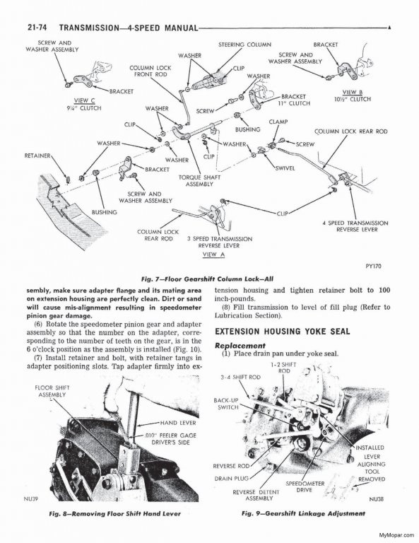

Any pictures of the reverse lock linkage on a 70 four speed?
Reverse lock-out levers between the steering column and the reverse linkage on the transmission.
They lock the steering and transmission when the key is removed.
Page 21-74 in the manual, you can download it here http://www.mymopar.com/index.php?pid=109
Yeah, spend an evening sifting through mymopar. Every diagram, FSO, wiring diagram you could want.
