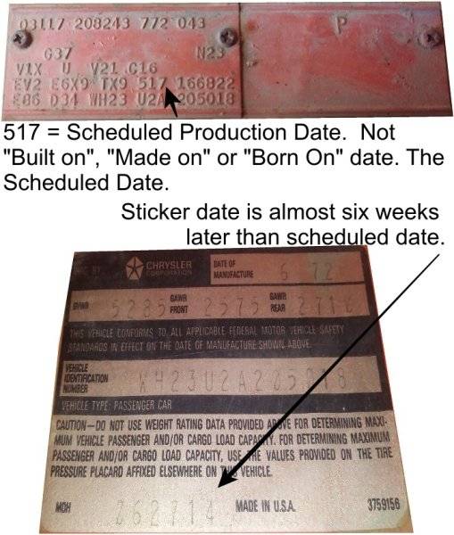

VINs and SPDs have little to no relation to actual produciton. There is absolutely no way to know 'build date' or 'build sequence order' from only a VIN or SPD. Therefore 'early' is a relative term. Secondary documentation is necessary.
An 'August car' may have been built in July. It may have been built in late September or early October.
