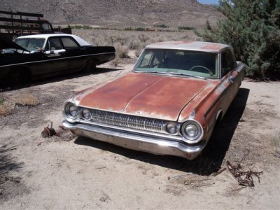

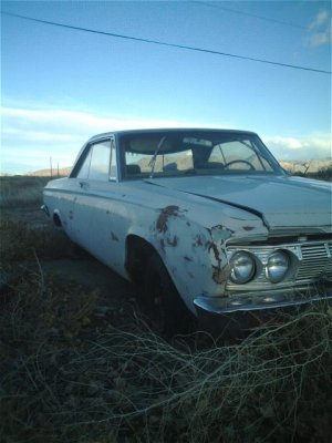

Ok, its more of a joke than anything but I have a nice 64 Dodge 330 4 door. I also have found a cheapo $500 64 Belvie that has a beat up front clip. Its a 3 dr 318 car. I was wondering if I could build something from the two for my 500 stroker motor.
Any way, any one ever tried mating the front clip of a Dodge up to a plymouth. I may have to look around for a plymouth front clip.

Well, not quite. Many export models in the 50's featured Plymouth bodies with Dodge front sheet metal and trim. The practice continued into the 60's with the 63 & 64 Canadian Valiant (but reversed). The Canadian Valiant featured a Dart body from the cowl back, and Valiant sheet metal and trim up front.
As for the 64 Plymouth and Dodge, the sheet metal on the doors and the cowl are the same, so the body lines will match up. But, the Plymouth has a shorter wheelbase than the Dodge, by about 3". Whether parts will be easy to swap or not will be dependent on whether the additional wheelbase length of the Dodge is in front of, or behind the cowl.
Since the Plymouth station wagon and the Dodge station wagon both rode on a 116" wheelbase, my guess is that the Dodge hardtops and sedans with their wheelbases longer than the Plymouth hardtops and sedans had the extra length added in the passenger compartment. If I'm right the parts swap should be easy.

Jim, if the body lines, door and cowl will match then the rest SHOULD be the easy part. By the looks of the replies, its either LOVE OR HATE situation. In any case, it would cost me $500 to find out plus hauling the car back. Maybe I should get a closer look at the 64 Belvie first. Do you think thats a decent price for that rig and that I could resale it for $500 if I dont build it? I really prefer the 63s, which is why I bought the 63 vert polara. But since I am doing that car back to original, I need a body for this monster motor I have that seriously needs a home.

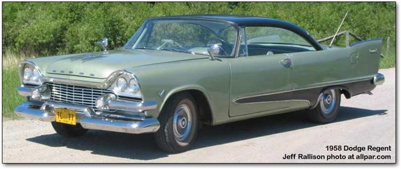

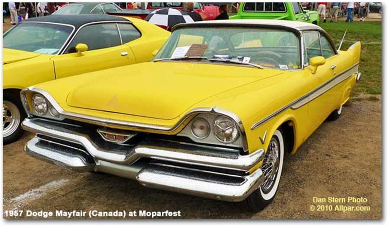

I grew up in Detroit and remember seeing Canadian versions of dodge and Plymouth hi-breds from the mid 50's into the mid 60's. Dodges with Plymouth front clips and Plymouths with Dodge clips. I think I even remember a DeSoto with a Dodge front end....(Or was it a Dodge with a DeSoto front end....????):confused:
It shouldn't take much to hang a Dodge fender on that Plymouth and see what happens.....
Ya gotta keep us in the loop though....
