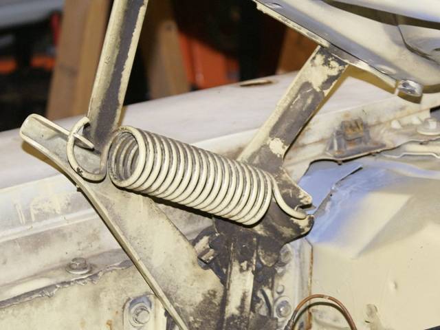

19 complete coils, had to buy Charger hinges to get them years ago.
Flat hood original spring, 18 coils

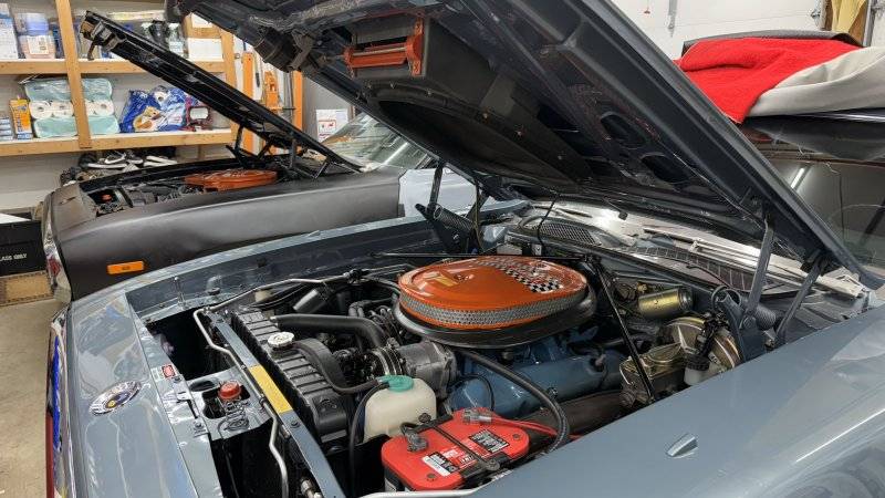

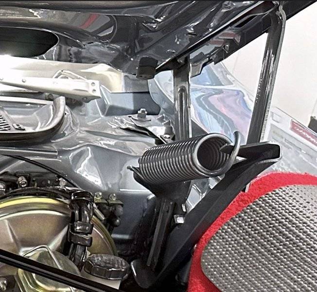

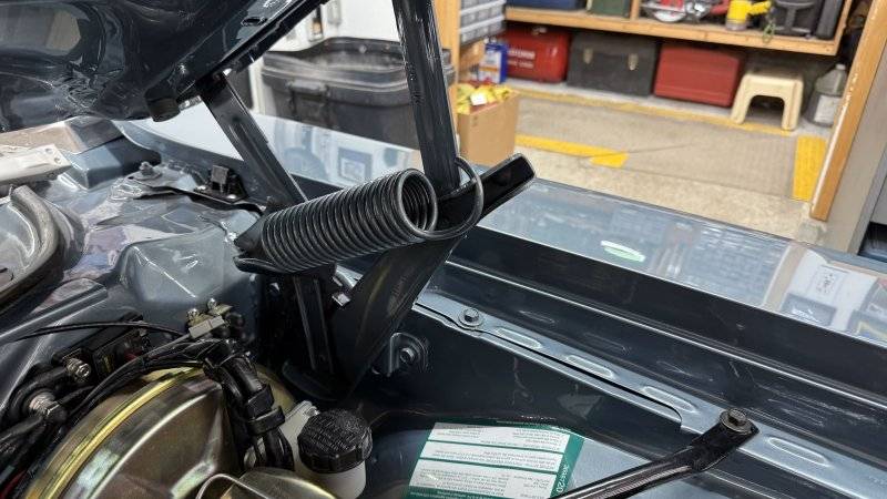

Update, just did another direct comparison. Flat hood spring is technically 18 and a half coils (note the orientation of the forward hook on the hinge), wire size is .225”. The A/G-Charger spring has 19 coils exactly with a wire size measuring .246”.
Both wire size measurements include paint.
flat hood spring
A/G-Charger spring
