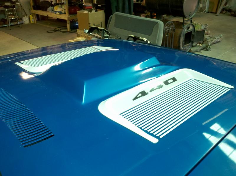

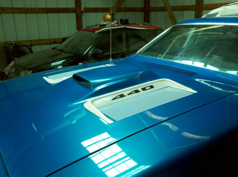

I do already have a hood scoop on the car my dad put on it years ago back in the 70's. it's been urethaned on also but don't know how well it will hold up once I start driving the car. also don't now how well an air cleaner will fit in the opening seen how the last time I seen the engine in the car I was 10 years old. I guess at some point I might have to fit the engine in the car for mock up purposes to find out for sure.
here is my scoop I have on the car now.

With that scoop you could maybe run a 12" diameter round filter with a 6" tall element or an Edelbrock-style oval filter and double stack 3" elements to get more surface area.
Bob
