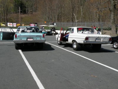

I am ordering a AAR fiberglass trunk lid for my 65 dodge coronet and was wondering has anyone weighed a steel trunklid before.
Does anyone know how much of a weight savings i will get switching over to fiberglass?. its going to be a pin on trunk lid.
