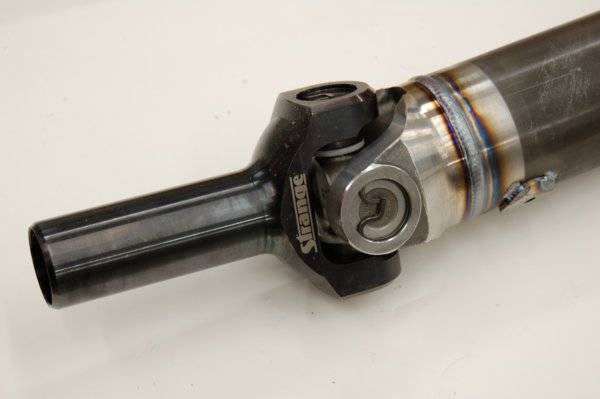

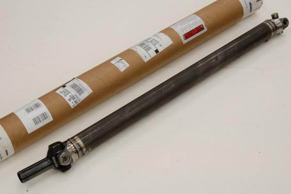

Call Cass at DoctorDiff and let him set you up with the right one. I just got one for my BB Duster. It is a work of art.

Call Cass at DoctorDiff and let him set you up with the right one. I just got one for my BB Duster. It is a work of art.View attachment 558953 View attachment 558954
