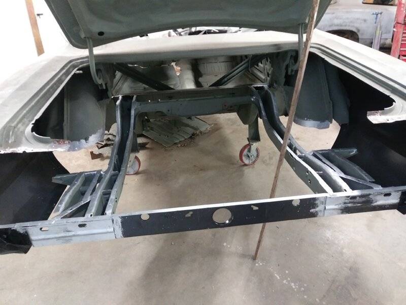

I noticed my bumper in the rear is a little crooked. Is there a procedure or process to adjust it ? I would like it to be even.

Loosen the bumper bracket bolts from inside the trunk n adjust it up or down n you can get a little side ways adjustment to keep it centred.
That’s the thing I didn’t see any bolts or brackets inside I saw some under the car.
this is on a 1970 satellite if that matters
The brackets are deffinatly between the rear of car n bumper,they wont be inside the truck.check around the rear rails support brackets.
there are 3 bolts on each side......under the trunk pan.......2 bolts are horizontal (the oval holes) and one is vertical going up from the bottom
