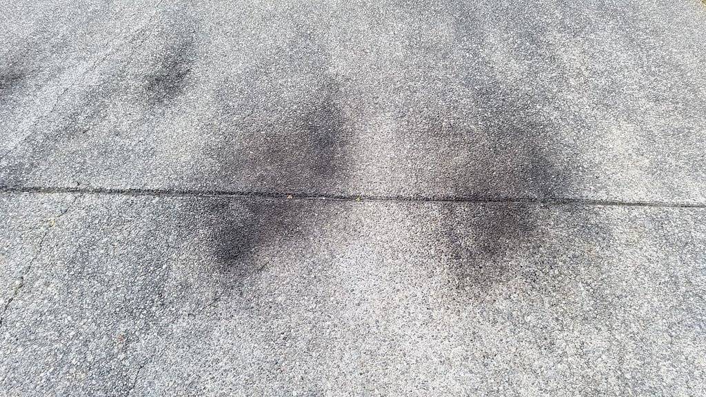

I have a brand new Holley 2210 2bbl carburetor on a 400 bb. When it's cold its leaving black soot on my driveway every time I go some where when I first start it up to warm up. Any advice on what to adjust on my carburetor.

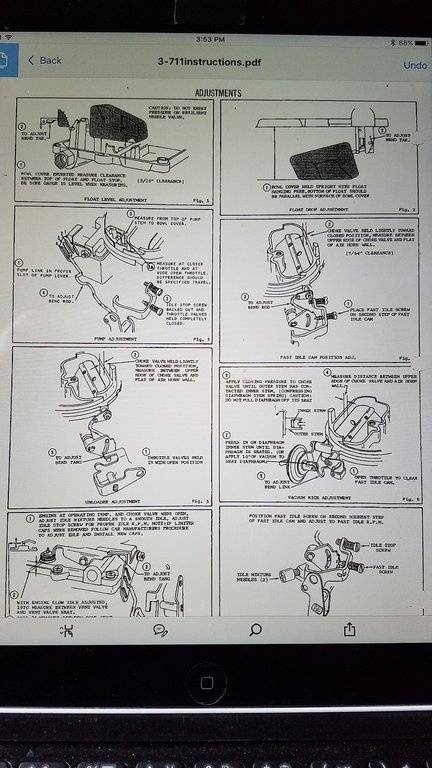

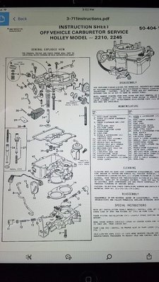

I'm not real familiar with this carb yet just started trouble shooting it. I have these documents to go by so far on adjustments.

#3 in left pic is choke pull-off, hook a longer piece of hose to it when eng. is cold. Suck on the other end of hose with your mouth & choke plate should pull open about 1/8" as in fig.9(?) in 2nd pic. Before you do that pull throttle partially back to set choke plate, should be some resistance to pushing the choke plate open. You can only do this on a thoroughly cold engine, let us know.

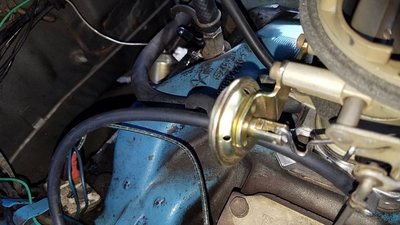

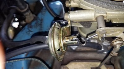

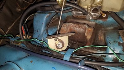

I took a picture after adjusting the choke like it said on the paper i had for the carburetor. This is what it looked like on cold start and when it warmed up. In the first pic its in farther when cold the when warmed up it went out some.
That pic is your choke pull-off, it moves the same hot or cold when running. Your first choke tension adjustment is down in the well in manifold. 3/8" nut if I remember that needs loosened and disc that is hooked to bi-metallic spring is rotated "slightly" lean or rich(more tension or less)

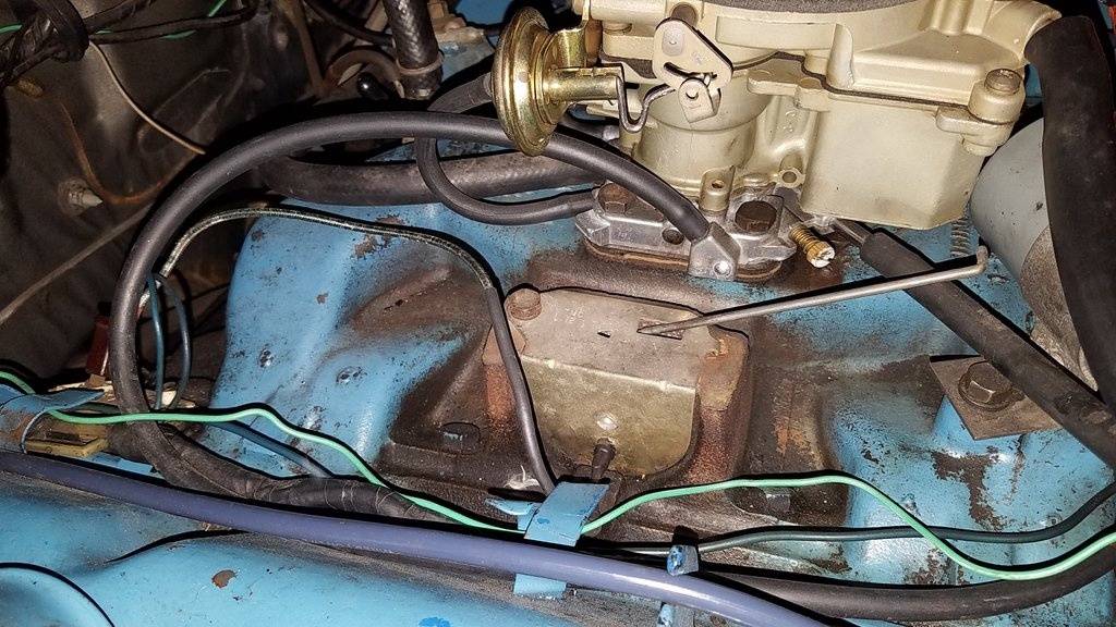

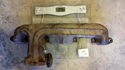

So after doing some research to understand what you meant by a heat riser I found out I'm not running one any more I took the stock manifolds off and put headers on. The pic below is my heat riser assembly you are talking about correct ? I'm sorry I think I've confused every one buy not saying I have after market headers on my car I'm sorry about that ☹.
Headers makes a difference only on how fast the choke gets hot&opens up all the way, you've still got a cold start problem.
