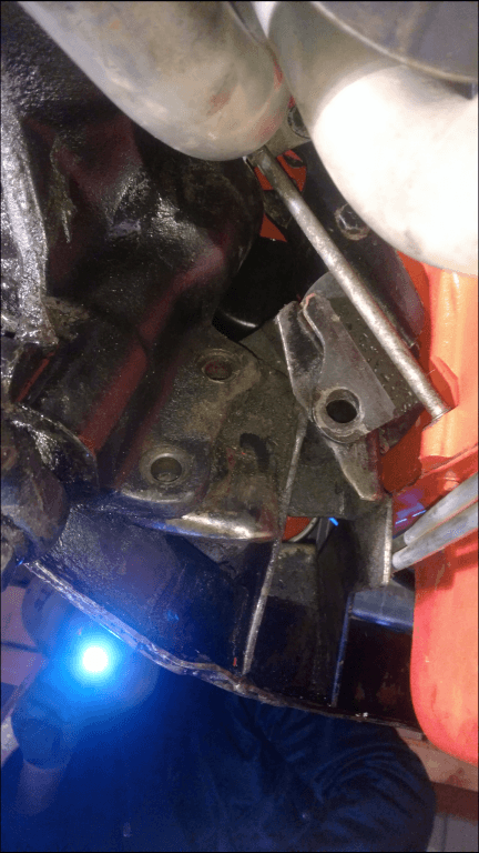

Hello,
Our goal is to raise the motor a few inches on the left side to make clearance for steering box removal (removing lh motor mount bolt, keep rh motor mount bolt in and use floor jack on the oil pan to raise. However when we attempted it, we only raise the entire car, the motor did not rotate. So we unbolted the right and engine mount and tried again, but still the car raised and not just the engine. Can anyone help give idea how to raise engine? The car is on a 4 post lift so we can't get an engine hoist in front of it to lift, so floor jack was our only option in our minds.

Is it only the long horizontal bolt that would need to come out to get the motor loose or am I missing a different connection point?

yes, that long bolt releases the mount from the k-member
