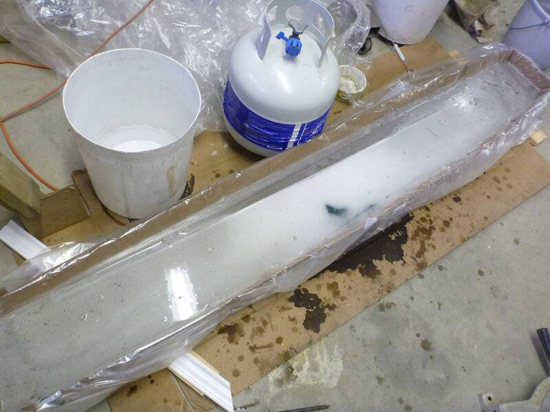

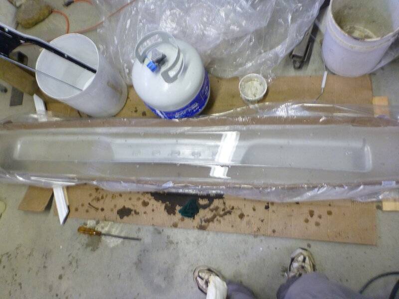

for long pieces of side trim get a long piece of gutter silicone end caps on soaking pan

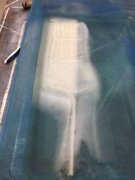

A rear tail panel piece submerged in the picture below. It's a clear picture, that is just the fizzing that's going on. From there you can finish off with some sanding, repairs, then give it a buff. Try out an old piece. The bottle in the previous picture is 6 or 7 bucks I recall.

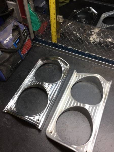

The lower headlight door was dipped in the lye crystals.
