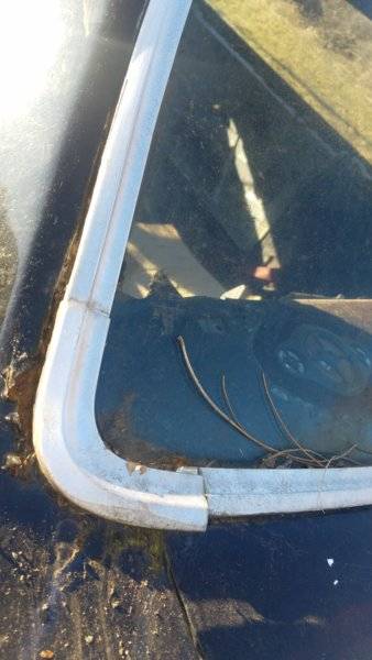

Can anyone tell me how to remove this?
I feel like I'm going to destroy it. Little plastic pry tools even seem to bend it?

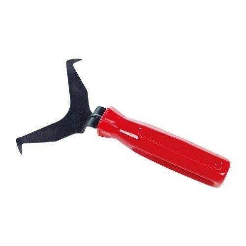

You need a tool that runs between the glass and trim that pulls the trim locks out.
Looks like this.. Slip it in the groove slide a pointy side in until you catch a lock then you rotate the tool until it releases the trim. There are several trim locks around the window.
You need a tool that runs between the body and trim that pulls the trim locks out.
Thank you. Does that slide in from body side, or window side?
Slides in the gap between the glass and trim. Posted a video above for you.
