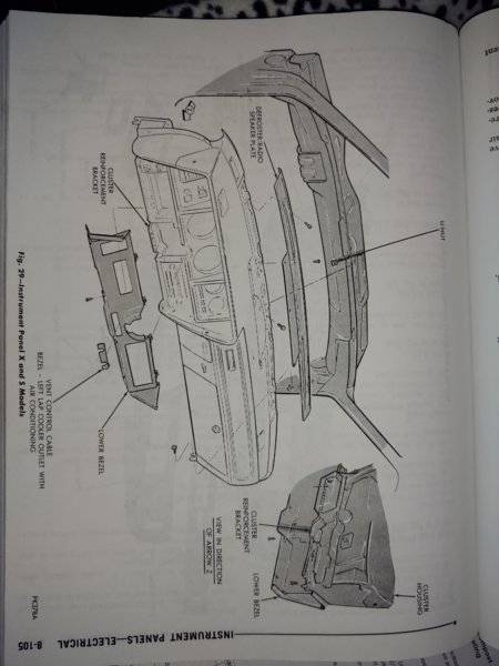

Have you pulled the speaker up out of the hole yet?
Hopefully, you can reach the connector from the hole in the dash, if not, you may need to pull the radio and get it from the back there.
As you can see from DeltaV's post, there is a connector there (unless someone replaced the speaker already and spliced it in somewhere).
