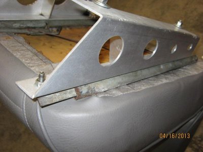

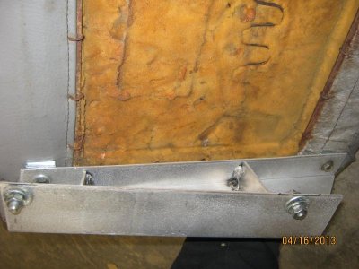

hi Folks,
Can anybody show me a Picture where i can see how the A100 Seat is mounted to the Lightweight bracket?
I´m trying to mount my A100 Seats to the 65 Race Hemi Seat Brackets that i got from http://ssandafx.com for my 65 Belvedere II.
But it seems like the Brackets are to short!?
Thanks
Peter

For what its worth, my brackets seemed too short also. I made adapters to make the brackets fit the A100 seat mounting points.
can you descripe what you've done?
Thanks
Peter

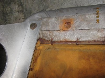

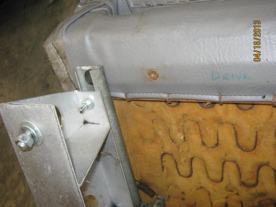

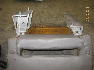

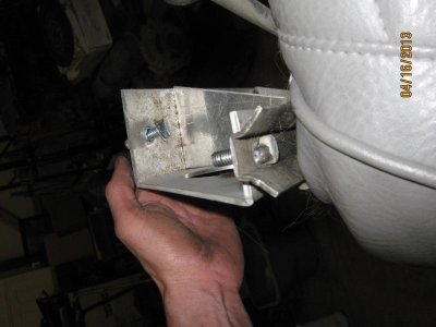

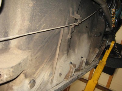

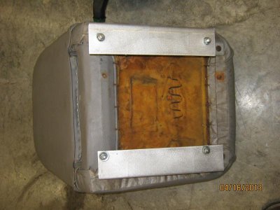

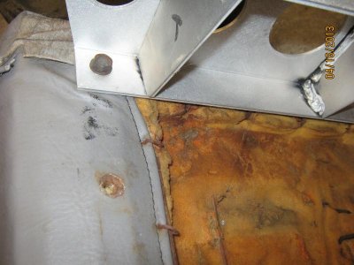

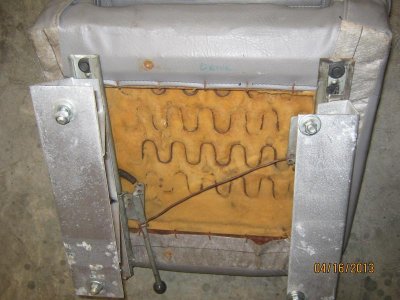

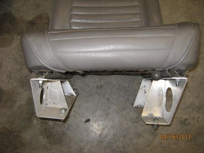

Ok here are the pictures of my seats. As best i remeber the actual seat frame had the outer holes that I used, I just had to add the threaded nutserts for the bolts. I just has to feel through the material to find the hole. You can see the original A100 holes that i did not use. The first pictures are of the passenger side seat. I also used the slides off the drivers A100 van seat to make an adjustable slide for the drivers side. If you you put the tracks flat on the floor where they should go you are fairly close to the dash or at least for my but I am
6'1". The floors in these cars drop off as you get close to the rear foot boards.
Once installed the passenger seat used the original two outer holes in the floor from the bench seat, but I had to move the drivers seat in to center it up so I had to make 4 new holes for it. I will attach a picture of the bottom drivers floor pan, if you look you will see 4 black plastic push-ins the I used to block the holes from the drivers S/S seat. I hope this helps you out. Matt

Thank you Matt!
I guess i have to figure something out
Peter
Thanks
I bolted steel bar to the existing mounting holes in the A100 seat frame and then bolted the SS bracket to the steel bar. Did this for each SS bracket. For alignment, the front hole of the seat lines up with the front hole of the SS bracket. My seats are stationary rather than adjustable like Matt's.
Thank you!
Peter
