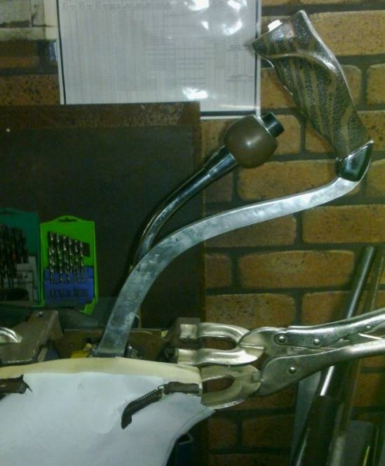

Hi,
I'm dropping a 727 into my 69 Coronet and was wondering if anybody in here has adapted a Hurst pistol grip shifter to work with a floor mounted auto? I think i'll user a Gennie shifter so there's no button to worry about.
Anyone done this and want to share any pitfalls or pics?

Yes, Push down and run it through the gate. There is a spring and seat that all bolt up to the original linkage very very simple to install took about 15 min. I painted my shifter mount. Check out the ducan web site.:headbang:

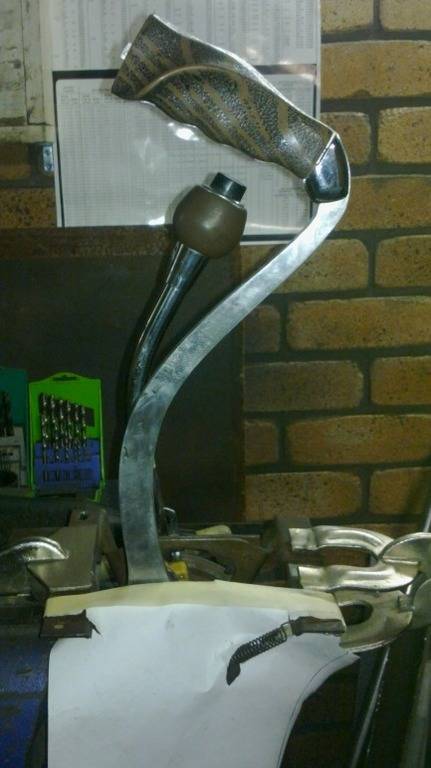

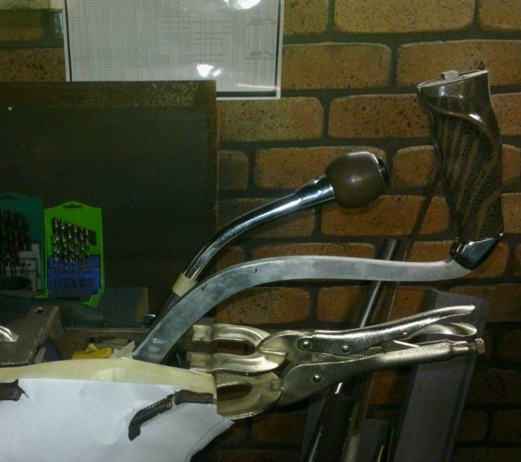

It's close but not quite what I'm looking for. I'm imagining this look;
I'm thinking it shouldn't be too difficult to put a Gennie shifter under the rubber boot. Gennies use a side action instead of a button so using the shifter should be easy.
