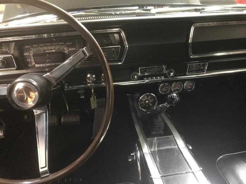

My 66 has a Hurst shifter with reproduction OE handle.
The shift throws in the gates with this shifter seem very long. I’m 6’2” and I have to lean forward to comfortably reach 3rd gear. I also have Ford Toploader in a car with Hurst and a repro 63 handle and a 66 Corvette with a Hurst and repro handle. Both seem to have much shorter throws - not unexpected on the Vette with a fairly short handle but the Ford handle is probably close to the length of the one in my Satellite and it feels like a much shorter throw in the gates.
I’m going to make another effort to find a part number on the transmission arms in my car but just from physical appearance they look Hurst, including bushings and rods. And my experience of seeing someone trying to link up a Hurst with non-Hurst shift arms is usually that there are big problems. The unit is adjusted including the shift stops and shifts fine. But kind of like rowing a boat going down the road.
Anyone who is running a similar setup - do your shifter throws seem unusually long? Maybe it’s just the way they are. I have the part numbers for transmission arms for this setup but when I looked before I didn’t see a number on mine. The numbers may be stamped on the inside. I’ll try to get I picture today.

Do not ever remember a Hurst looking like that. What's the name of the other shifter Mopar used?
I find my HP2 the most tiring car of the fleet to drive. Still has the inland, but it's a WAY over there for third, vs the shifter beside my knee in the Bee.

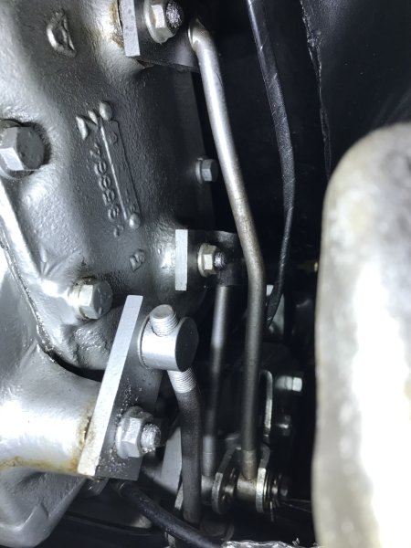

Interestingly I went out and measured the throw of the Satellite and the Ford and both actually do have about the same length throw at the ball. But the Ford is in a Cobra replica and the transmission and shifter are quite a bit further back while the Plymouth is pretty far forward. So I guess that’s basically the difference. The levers have to be Hurst, they do have numbers just pretty faint and the 1/2 is blacked by the 3/4 rod.
Inland Shifter I believe. The handle on mine is a replica in that it’s modified to bolt to the Hurst shifter.

I guess the long reach and throw on these cars with a console is basically a side effect of the offset in the shift lever to the right to get it to come up in the center opening of the console plate. I don’t think the non-console cars have the off set and thus the shifter is closer to the driver and at hand.

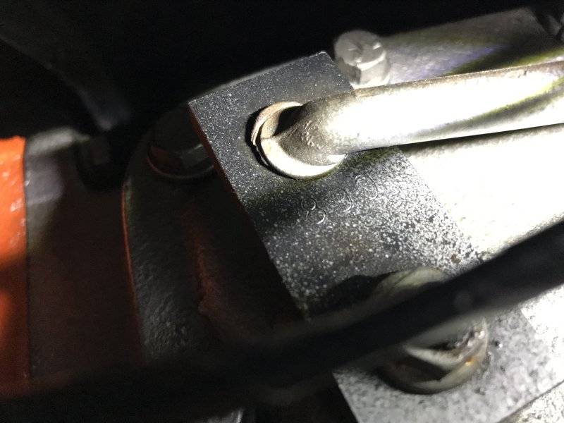

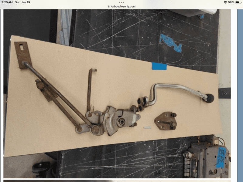

the number shown on the shift arm (890 ) does not look like a Hurst arm number ,, also Hurst shifter arms have rounded tops and bottoms yours shown is straight cut ,, so maybe you have a mix and match combination of factory stock or Mr Gasket shifter parts and Hurst parts , i believe the install kit for your car should be Hurst 373-4089 ,, look it up and you will see the difference in the shape of the arms and some photos actually show the Hurst part numbers for the correct arms. ,,,, stop bolts are only used on the 3 - 4 shifter arm.
Thanks John. I was thinking that Mopar shift arms from Hurst were square cut but now I bet I was thinking of Inland shifter photos I’ve seen. So I may have a mis-match in parts in a Hurst
shifter and Inland transmission arms. I need to take another look at the rods too. I looked up the transmission arms on Shifter Jacks website and found what seems to be the current part numbers 1053894 & 3738617. But I’m going to have to double check these numbers as there are a lot of out of stock and superseded part numbers.

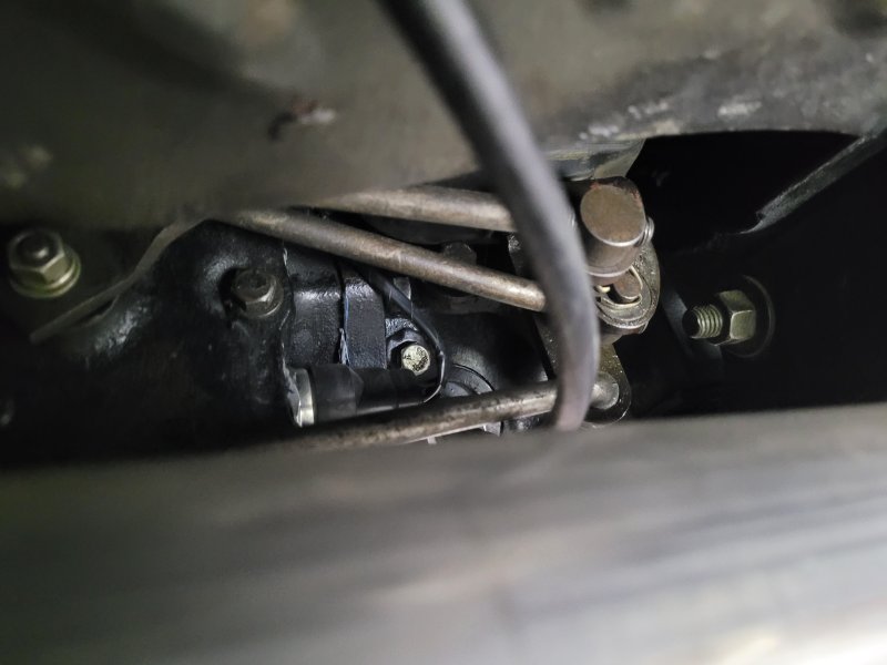

Anyone have a picture of a 66-68(?) A833 with stock inland shifter and rods? Need it to compare to the rods on my car to determine if they are Hurst or Inland.
Thanks

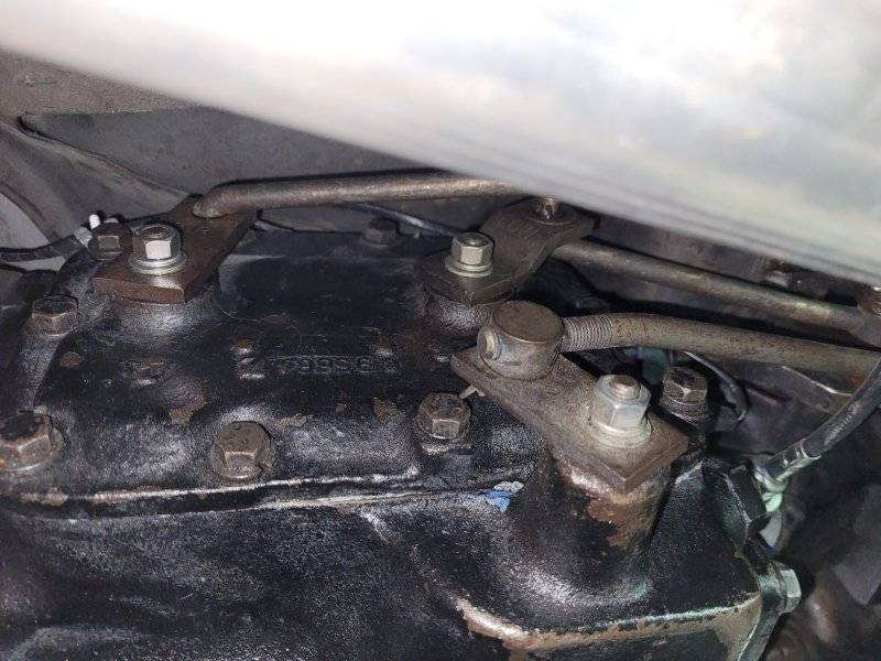

I’m not real sure from crawling back under my car. The 3/4 rod has a single bend in it (not straight the Inland one below I found for sale) and for some reason the put the reverse rod in backwards.
Here is mine - looks a lot like dadsbee.
I may just order the arms and see if the rods will work as they are not listed on Shifter Jacks site as available except as part of an entire installation kit.
Thanks Wayne. Interesting that your reverse rod is reversed too. Maybe that’s the intended installation.
I guess I need to get under there and pull a rod loose and see if the end will fit a Hurst bushing. If Inland rods don’t use bushings the rods may not fit the Hurst shift levers properly and I’ll just need to order a complete installation kit.
