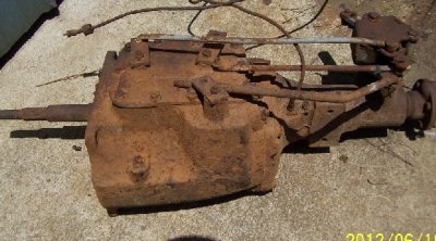

Here is a picture of one with the bolt on shifter handle that one of my "FRIENDS" borrowed the handle off of over twenty years ago. I kinda got the impression he ain't gonna bring it back. I am pretty sure it is a Hurst shifter. It's a mighty small picture I hope you can see it. By the way I no longer have a use for this 4 speed for an early A body.
