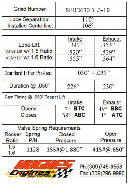

I am replacing a cam and head setup on my 440 - 6 pack using 240 Trickflows heads. Four speed, 3.54 gears, #4000 car. I have heard that hydraulic roller lifter cams have advantages like durability, better oil selection without zinc, broad torque curves etc. but after viewing reviews of products needed to support the roller cam valve train setup I get mixed feelings. The roller cams require components like adding a cam button and changing out the intermediate gear and pump rod. Reviews mention expensive pump rod and intermediate gears that wear out. Also cam button failures.
Which brands work best to use? Mopar? Comp Cam? Bronze intermediate or melonized? Hardened steel pump rods or bronze tip rods, nylon cam buttons or steel/washer?
I really don't want to sacrifice longevity and have to rip apart the engine because I thought I was getting a durable cam/lifter roller setup but the other components fail....
Roller cam:
Or option 2 - flat tappet cam:
Any feedback from past experience would be great. Thanks!

I do not find exact matches in the Howard lobe catalog but these should be close enough for dynamic compression Analysis
for the HR
278-280 @.006 intake [email protected]
284 Exhaust 153 @200
HFT
[email protected] 148 @200
279 @.006 152 @.200

Well.....I wish I could give the tech at Bullet cams a jug of water because his mouth must be dry from all of my questions. He should also get an award for his patience. I will try to sum up some things just to share some info gained but remember I may not have responses to any more technical questions.
Bullet cams are custom ground so don't expect to see a typical catalog. The website catalog isn't working right now. After discussing pros/cons I think I have decided to go with either the solid tappet or the hydraulic flat tappet. It seems the intermediate gears and pump rods used for rollers do wear out. For street applications approx 3,000 miles or more depending on products out there and I don't want to to disassemble the engine or even have to think about it. The car rips up the road already and I don't have to be the fastest guy out there.
I can't cut and paste but this is what we came up with:
For the street/strip it was recommended I use a Ford lobe design given the street application and idling situations. The "fast ramp" "extreme" Chrysler lobes put a lot of stress on components not to mention lifter bores. The faster an engine rotates the cam rotates slower and cause issues with oiling. Newer engines might have this under control. I know roller setups have nice improvements but my situation is mostly street with an occasional - out of control asphalt ripping...
I was able to get some specific spring pressure to look for using the Bullet cam so I have to call Trickflow. I am looking for:
-Seek #135 - #140 install height 1.855 instead using the standard 1.460 OD springs that come with the Trickflows which come #120 @ 1.900
-Try to get #360 open spring pressure @ 1.300 height given the cam I plan to use has .555 lift using 1.6 rockers. I have to find out which shims will achieve this.
- The custom grind will be:
3 bolt
106 center
109 + 3 LSA - not sure what the plus 3 means...
INT HF (Ford) 287/3471
EXT HF 295/3471
INT 235 @ .050
EXH 243 @ .050
Lift .555 for both using the 1.6 rockers
Valve seat closings: ( I would not have asked this had it not come up. THANKS!)
Maybe WYMRRYDER can make sense of this?
INT 12
INT 44
EXH 54
EXH 10 degrees ATDC
Lifters (Made by Johnson) LH 1977R
Use Break-in Joe Gibbs Oil
BR30 - 7 quarts
Thanks for all your replies!
The individual IV 12, INT 44, Exh54, Exh10 figures are valve events at .050 tappet lift. The +3 means the cam is ground with 3 degrees advance, ICL is 106, lobe separation 109.
