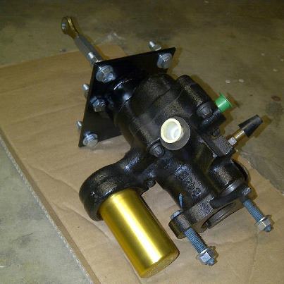

One of the good things about having an interesting project going is that people are more then willing to help in most cases. One of the hydro-boost distributors was just here and did all the measurements to build brackets for our cars. He is going to start building them and will have some available starting next week. He sells the hydro-boost units as well so I am sure he will have it as a package. Not sure what the retail price is going to be for the setup yet, but I will post pictures as we get it all together like I normally do.
Pretty much done. Mate up the brackets and mount it up
That's pretty badass. Does it take a GM master cylinder? Like late 80s early 90s, right?
It does. It is done at this point, just need to install it.
Please keep updating. "I" am very interested even if no one else might be. This would be a great application for those with radical cams that want power brakes.
I wanted to make sure I had brakes when moving from 15 PSI to vacuum. I think this is an awesome system. Everyone I know that has it loves it
How well I know. It worked like a big dawg on those old late 80s and early 90s GM station wagons.
