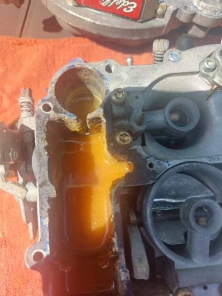

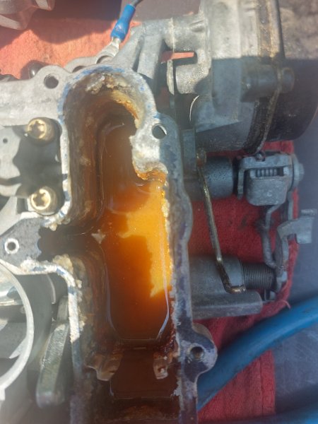

No matter what your tune, the % of ethanol in the fuel will result in about the same % loss of fuel economy. Add to that, if you let ethanol fuel sit in metal fuel tanks for long periods of time the corn turns to water and rusts the tanks, clogs the fuel filters and carburetors.

I don't have a choice but to run ethanol here in this state. As long as it is cycled through and does not sit for months, it seems to be okay. Maybe the mild climate helps with that? I've seen the scare stories about the extensive damage that others have seen with ethanol but the worst that I have seen is quicker failing rubber fuel lines and crud in the carburetors. No fuel line or tank problems so far.

Yep, Kern rubber fuel lines turn to mush, fuel pump diaphragms fail, etc. I replaced 4 fuel tanks before I learned my lesson. That was over 20 years ago. The only ethanol fuel I have got since was sold by a station that was cheating the public. They were selling 87 ethanol fuel for 93 non ethanol. My one Hemi car at the time started to detonate under acceleration was my hint. I turned in a gallon to the state for testing and they shut the place down.
