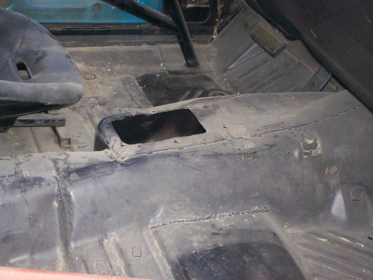

Your car MIGHT not have been involved in an accident. My brother-in-law and I bought a 1970 Cuda race car back in 1979 that was an original 440, 4 speed, Dana 60 car. It had a 426 Hemi and Hemi 4 speed in it when we bought it and had been used as a drag car most of it's life.. When we started tearint the car apart to start building it into a serious bracket car, we found out that it had a pretty good "kink" in the transmission tunnel, so we took the car to a well known local frame shop and found out that it had a 1.5" bend in the car that was caused from heavy torque loads from being raced hard without a roll cage or sub frame connectors. The frame shop straightened it out with no issues and we were good to go. Uni-body cars are known to have issues like this, so don't fear the worst yet.
