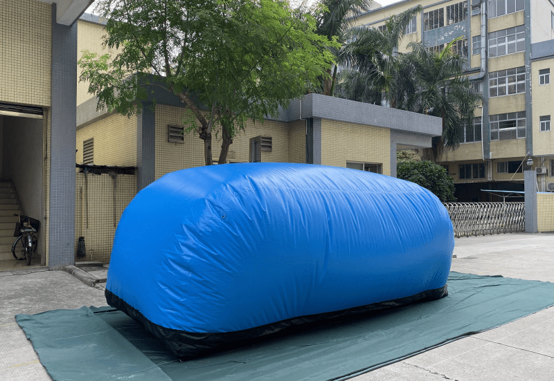

As for some of those "gimmicks" like the inflatable air chamber, that thing has constant pressure to keep it inflated. What does that mean? Well, the car will heat and cool based on the outside temperature. So imagine after a week of freezing cold you get a nice warm day. The inflator now pumps in the nice humid outside air - which condenses all over the freezing cold car. So cross that idea off the list.
