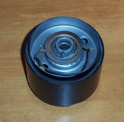

I asked Dale's via email what the adapter was for, the answer below still bewilders me because I don't know what is different between my factory steering wheel and the optioned tuff wheel. Don't all wheels have a 3 bolt pattern?
Answer from Dales:
The adapter makes the column a 3 bolt pattern mount which is what the tuff wheel mounts to.
Nope.
Only tuff and rimblow.
Evrything else just press fits on the splines.
That's where the "can" comes in.
It has the splines. The wheel "bolts" to the can with those three beveled nuts.
As YY1 said. Here is a good shot of the adapter. You can see the spline that goes to the column, then the wheel mounts to that. It also brings the wheel closer as Tuff wheels are very flat.

I understand I will need three components: steering wheel, adapter, and horn button. But ODZKing provided a foto in the previous posting above that shows another item. What is the fourth item on the lower left next to the three fasteners? Thank you.
