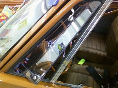

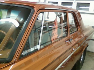

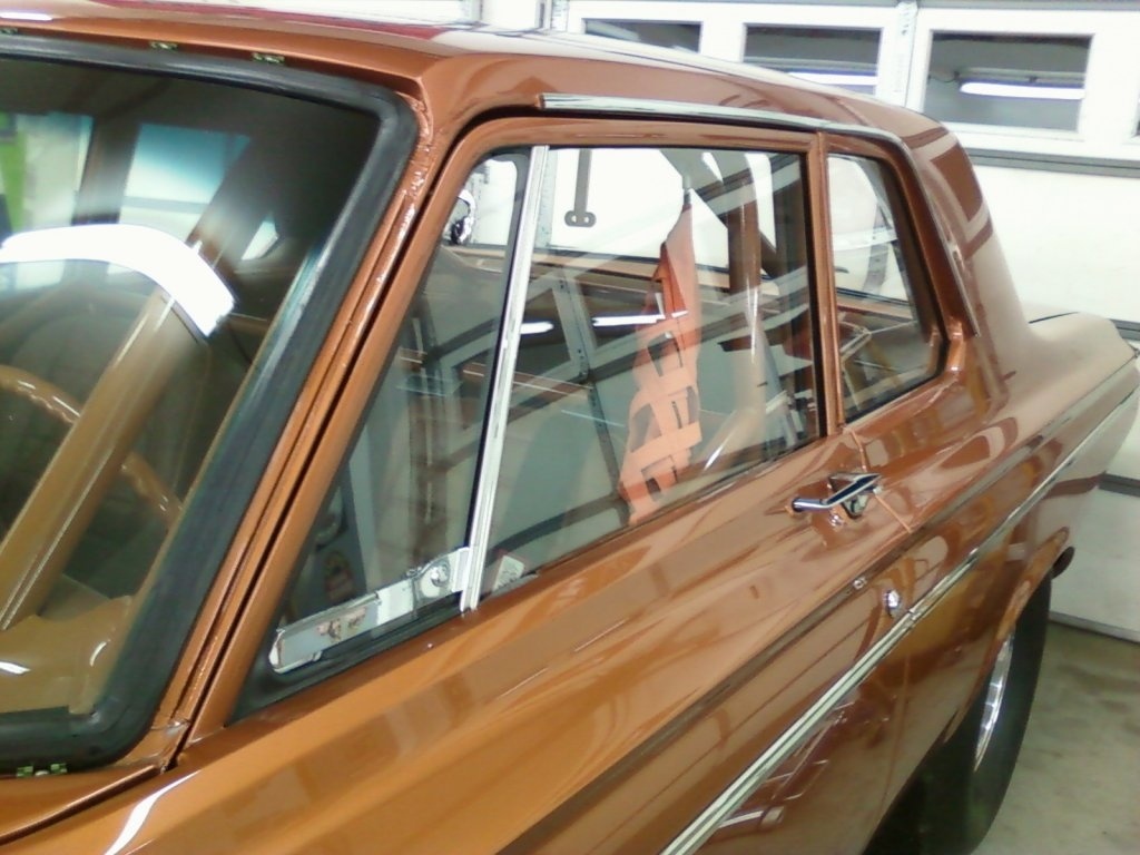

Gut them, Lexan and no regulators. You can loose 30% of their weight. I can get my 64 Belvedere down to 3290 with me. All steel including the bumpers except the hood. Full interior minus the back seat.

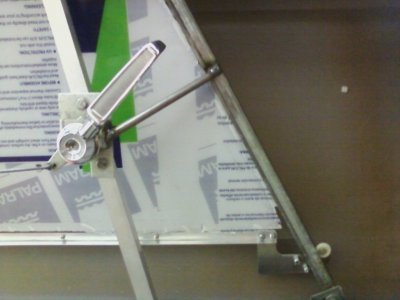

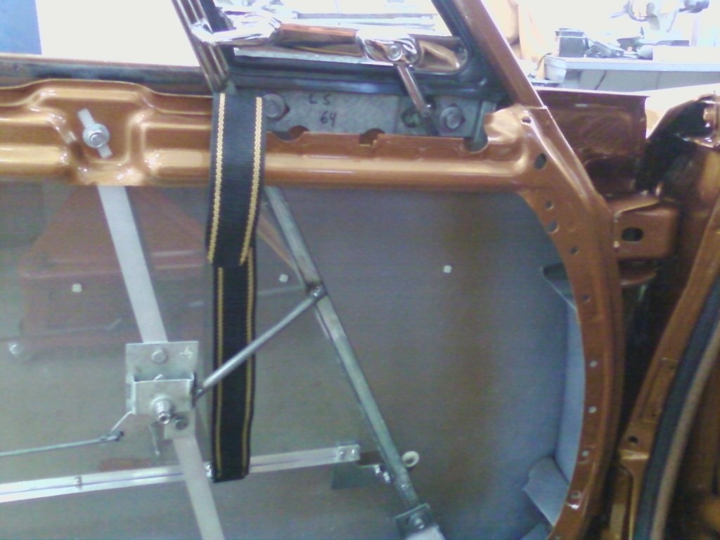

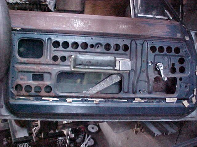

Cranky's door shows great use of the hole saw. Could even hole saw the window apply arm. Doors sure not the same as a stock E Body!!
Actually, a hole punch....a Greenlee knock out punch to be exact. Makes a much cleaner hole than a saw does. And I know about those heavy *** E body doors!! lol. But they also can give up a lot of weight too when that danged side impact protection rail is removed....

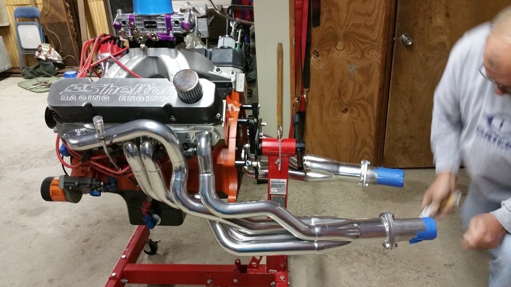

Mind Sharing the engine combo?
Well, a stock 3370 weight car would be one that came with a /6 but mine also was an automatic and had a working AC. I'm finally getting back to working on it after taking it apart several years back and am still massaging parts for weight. The K frame that's going back in weighs 32 lbs which is 10 lbs lighter than it was stock and is now solid welded. As for the engine....I have a stock bore 440 that's been sitting on the engine stand for longer than the car has been apart but I want to build a stock stroke 400 with at least 10.5-1 and aluminum heads, aftermarket rods etc etc. Have the heads and just about everything needed to build it up but the block needs to be prepped and on and on. The 440 is ready to drop in so it will probably get the nod then go to work on the 400 and enjoy the car some. The motor is 10.3 with closed chambered heads, 'mild' cam, titanium retainers, Isky ductile iron rockers and a few other goodies...

When I gut, I cut. Everything moves. And yes the vent is Lexan also.
Doug
