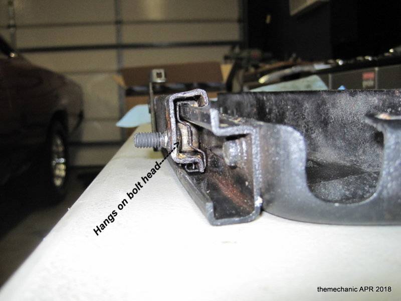

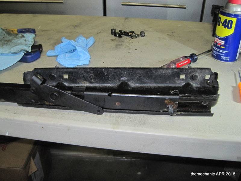

I posted a video from a guy on YouTube about how to do this. He makes it look easy. @ hours into it and still can't get the roller cage out on the bolt end. I tried tapping the bolt out but it's too tight. Can anyone tell me where I went wrong?

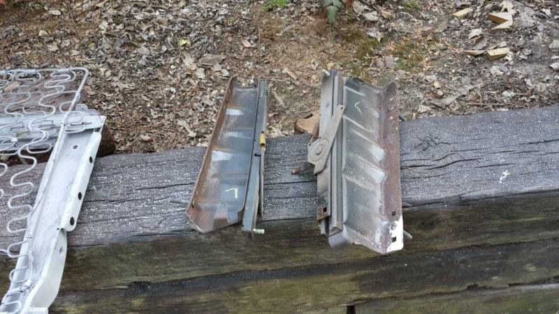

It's comes apart?

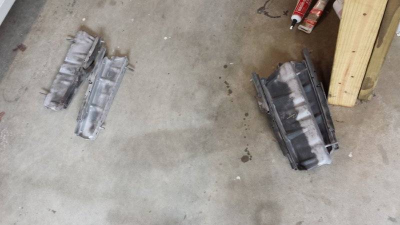

I just sand blasted some last weekend along with the seat bottoms.
A quick look seemed to indicate there are rivets holding the two together and stopping the movement fore and aft.
I'll have to look again.

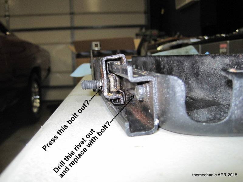

Well, I've come to the conclusion I need to either press the carriage bolt out or drill the last rivet out and replace it with a bolt and nut when I put the slider back on the track. What think ye?
i drilled the rivet out bought a nearly identical one at the local hardware store, put it in a vise and crushed it. drop of paint and can't tell it from the rest. used silicone food grade grease its clear, no smell. works like new.
I was starting to bend **** so I gave up and drilled it. a lot easier to get it back together too.

Mechanic you are correct in your assumption. I did take a grinder/dremel and remove the swedge on the carriage bolts befor tapping them out. It the don't tap out do a little more work on the swedge. Otherwise you'll tweak the tracks. I'll see if I can give you a link to my thread.

The rivets are solid steel of 3/16" diameter with a 3/8" diameter flat head with a head height (thickness) of 3/16" and a total length between 3/8" to 1/2".
I can't find any flat head rivets with a head that thick. So, I'm going to use a round head rivet instead. Only you guys will ever know.
In hind site, it is better to remove the bolt like 69GTX did in his build thread. Live and learn.
