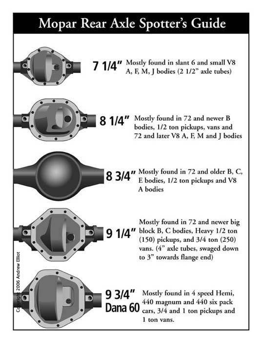

The 8 3/4 fill plug is in the front area of the housing. The 8 1/4 will have a removable cover on the back and the plug is on that.
It has a removeable cover with 10 bolts but no acess hole in the cover. It looks just like the pic you provided of the 8 1/4 ( acutually I think it was one of your pics that helped me indentify it. Thank you!) But up on the right side of the body there is a big threades plug I'd say about 3/4 of an inch with a square head that fits a 5/8 open end wrench.

If you can, take a pic of it and post it but it sounds like an 8 1/4. Not sure and I don't know if the ones back then were set up like that. The 8 1/4 that's in my 95 Dakota has a pull out plug in the cover....other words, it's a rubber push in.
Well Cranky you sure are right about that. I've got 2 Dakotas a 98 sport with the little 2000CC 4 banger and a 07 4 door with a 3.7liter. And they both have what looks like a 8 1/4 with a push plug. And my satellite looks almost exactly like that but the cover is not quite as flat (but almost) where the push plug is ans it seems to be about 9/10th the size. I do have the owners manual who says 4 & 1/2 pint and a after market seervice book that only tells the type of fluid but not the amount. I'll shoot some pics but I will have to email because I have not figured out hoe to post here. Any thoughts on the fluid level?
60's and 70's 8.25's don't have a fill plug in the cover as in your picture.
It is a 74 rp23c4c108xxx and with a D34 transmission code that just says torqueflight E44 engine simple 318 2 bbl and no specific rear end code that I can find on the fender tag.
