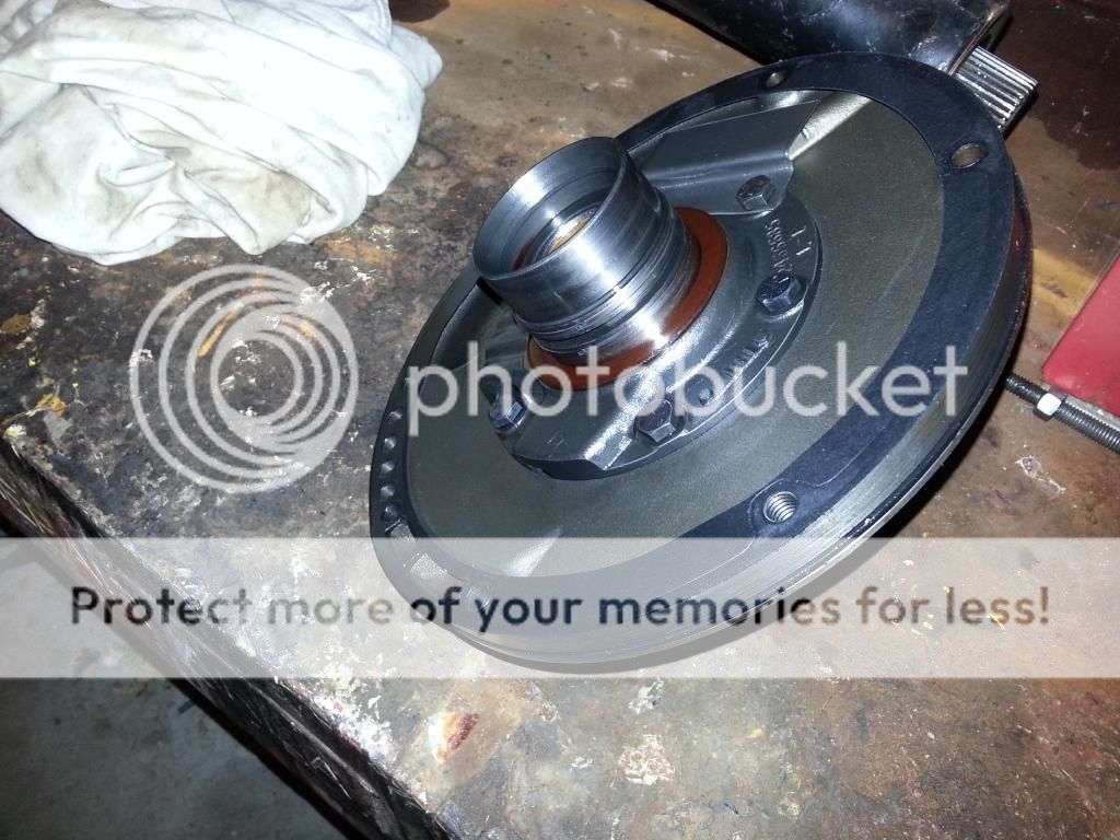

One another note I pulled the pump out of my 1970 727 that was in the car and I think that someone swapped the pump support out for the wider 71 and up if I'm rite please correct me if I'm wrong .
Here's some pix
Thanks Mike

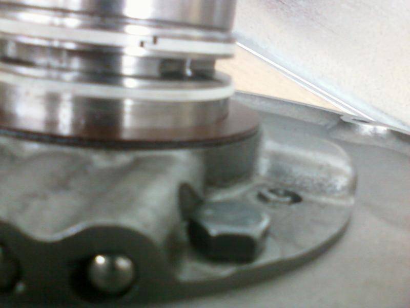

The early kick down servo with inner and outer springs is good also. Remember to follow the trans brake instructions as you may have to drill a hole in the high gear drum. Possible it's there already though. Drill a new vent hole in the rear of the case and plug the front vent. You can modify the front reaction shaft with a cut off wheel ( see CRT website). This isn't a very good picture but look at the right side at the drum oil feed hole. Notice how it ground down to the intersecting hole.
Doug
