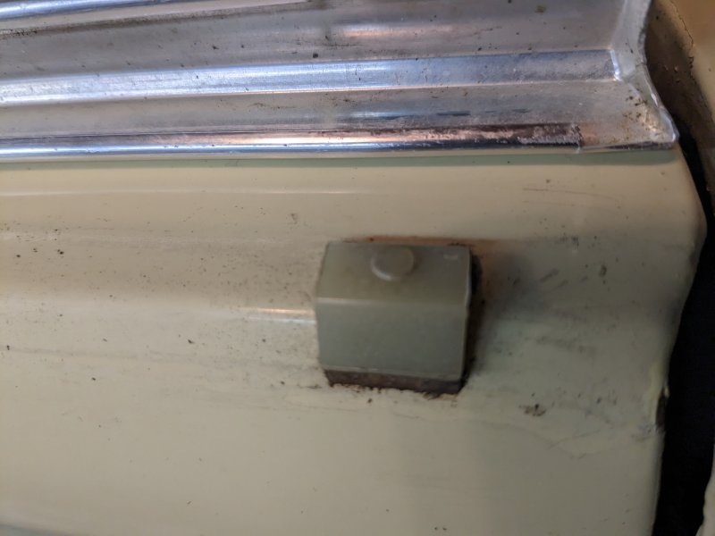

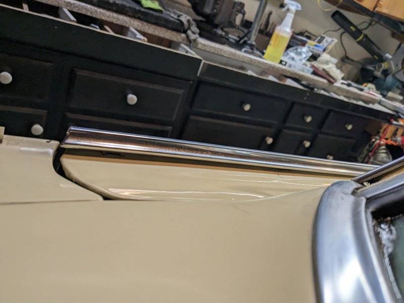

Went I put them back on & they are very sloppy and won't stay on the clips.
I did not damage the clips taking off the molding.
Do I need new clips or is there a trick to it

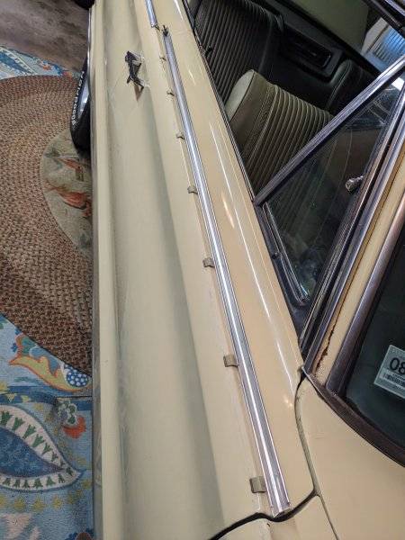

Start by cleaning the dirt from the edges of the clips, a wet toothbrush works great.
The trim goes on the clips at an angle. Don't go straight down on the clip, you will bend the edge of the trim or break the clips.
Put one side of the trim on the body next to the edge of the clip, the other side of the trim will be on top of the clip. Use a rolling motion and snap the trim over the clip.
Run the mldg in your grip of your hand and slightly squeeze the mldg together
Put one side on. the slide the opposite side over the clip ( DO NOT HIT IT WITH YOUR HAND ) You will bend the mldg trust me

seem the clips are too narrow to catch the trim
That makes a lot of sense
I will try that....
yes it's aluminum trim, softer than stainless by a wide margin.
THANKS.......Your suggestion worked perfectly
Ive had that trim on and off a couple times. And that has worked best for me.
Just don't squeeze it too tight. It ends up with waves in between each clip.
This above. I made a litt go/no-go gage from a pop cycle stick or something for just the right width to secure to the clips and went down each molding marking wide sots with a marker. Then I laid the trim on edge on a flat surface and with careful hand pressure (they are soft), massaged the wide areas down to where everything was straight when eyeing down its length. Then flipped it on the other edge and repeated that and sighted down the edge. You can use a straight edge to check to. When the gage just barely cleared all the way down, they snapped right on.
