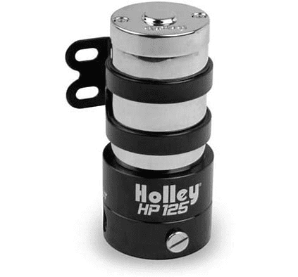

Thats what I was just telling my wife lol. Any recommendations on electric pumps?
geez that baby is 500 bucks!, what about a good old Holley red?
But... it's q-u-i-e-t. I gave up traditional pumps ( Holley red, blue, Carter, etc. ) many years ago. Too LOUD ! A gerotor pump is a different method of liquid delivery which results in substantially quieter operation.
if you can hear your pump over your engine and exhaust then you're doing something wrong. lol
Id put a cheap electric pump on it and measure the pressure. Then run it. If it runs good then the only thing that might motivate a change would be the noise. But who dives these cars expecting a smooth ride that is quiet? I love the Madmax Interceptor noise…..
