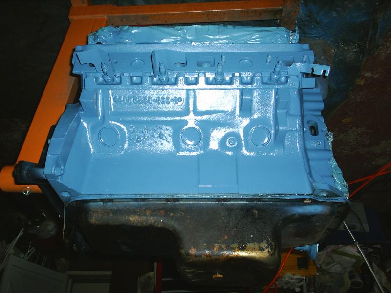

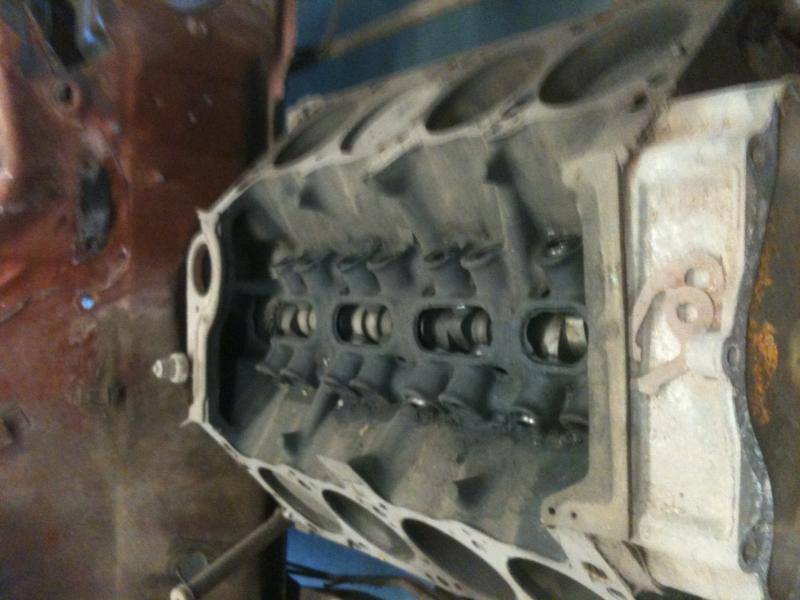

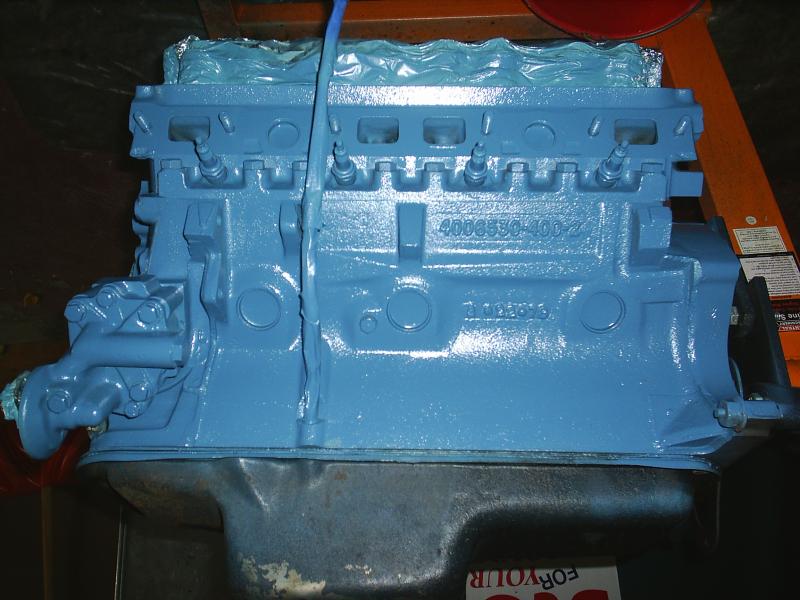

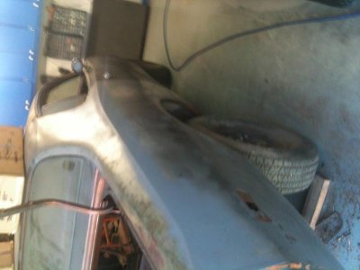

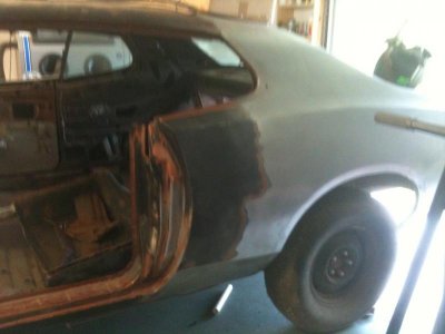

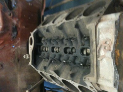

Ok on the right (passenger) side of the block is this number 86145-23. On the lift (driver) side is this number 4006730-318-4. So I am thinking it is a 318. Here are some pics. trunk.jpgrt side.jpgfront lt side.jpglt rear panel.jpgengine.jpg

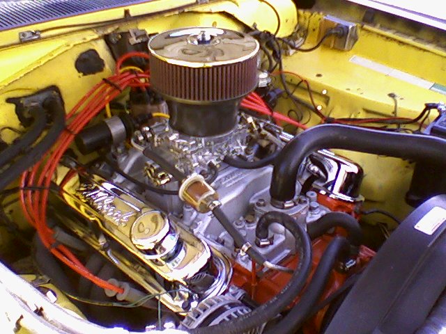

that wasn't meant to discourage. as a matter of fact I have a lot of respect for the 318. I just didn't see why it was important to know whether or not it was a car or truck 318. there is virtually no difference other than the pan/ pick-up tube , exhaust manifolds , and maybe the crank being drilled for a pilot bearing. that little teen in my yellow 73 duster would **** n' git
a couple of my 318's ...............

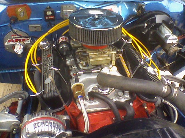

318s need a cam,headers good intake and carb and you have the makings for a nice peppy cruiser.Been a long time since I had a small motored car and they are surprisingly a good little engine.This is in my Barracuda.

That is a post-1976 318. The -3 means it is the 3rd casting of that engine.
I'm told after so many castings they wear out and loose detail so they make another and that is how they identify them.
See http://www.mopar1.us/casting.html
Yes, they were used in Dodge Ram's 76-79 but not exclusive to.
See http://ramchargercentral.com/engine/la-engines-273318340360-part-1/
If you google "4006730 318 Mopar" you'll see posts where folks have a -12 (12th casting) so I would say as a guess probably closer to 77-78. What does the clock say on the side? You can see the clock and date tag in these pics of mine.
If the pan rail pad is on the right side of the block the VIN is 86145-23. I will finish pulling that block apart to see if I get a bonus or a big surprise. Thanks for all the input.
