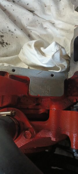

Can anyone give me any information from my drivers side stamp on the top of my block?
Show us the numbers cast on the side of the block and the ones stamped on the oil pan rail, rear. They all work together.
that is not a factory stamping on the pad. likely a service black, get the casting date on the side of block by starter
I will see if I can get pictures of the rail stamp. I have a receipt from when it was rebuilt. Maybe they stamped it on the top.
There HAS to be a block casting date.
My guess? Warrantee block, date of install. Vin pad can be blank if it's a warranty block. Those are not factory stampings or fonts.
Block casting date driver's side. Could be a warranty short block?
11-16-72 could be assembly date.

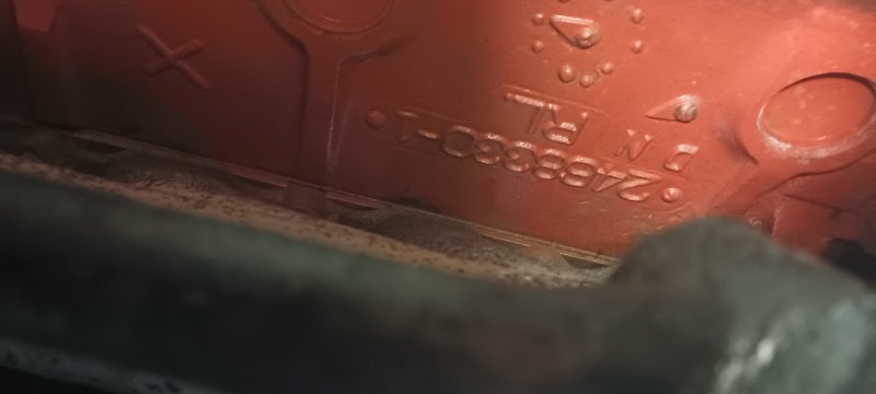

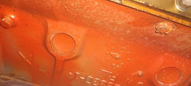

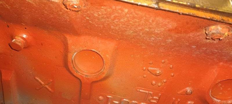

Here are pictures of the casting numbers. O dont see anything on the rail with the oil pan in the way.
Passenger side. Should i take some of the drivers side. Im in the garage now working.
