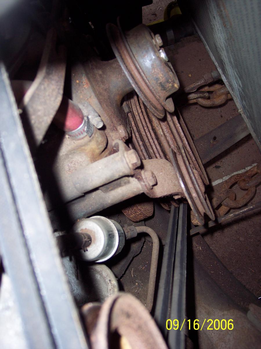

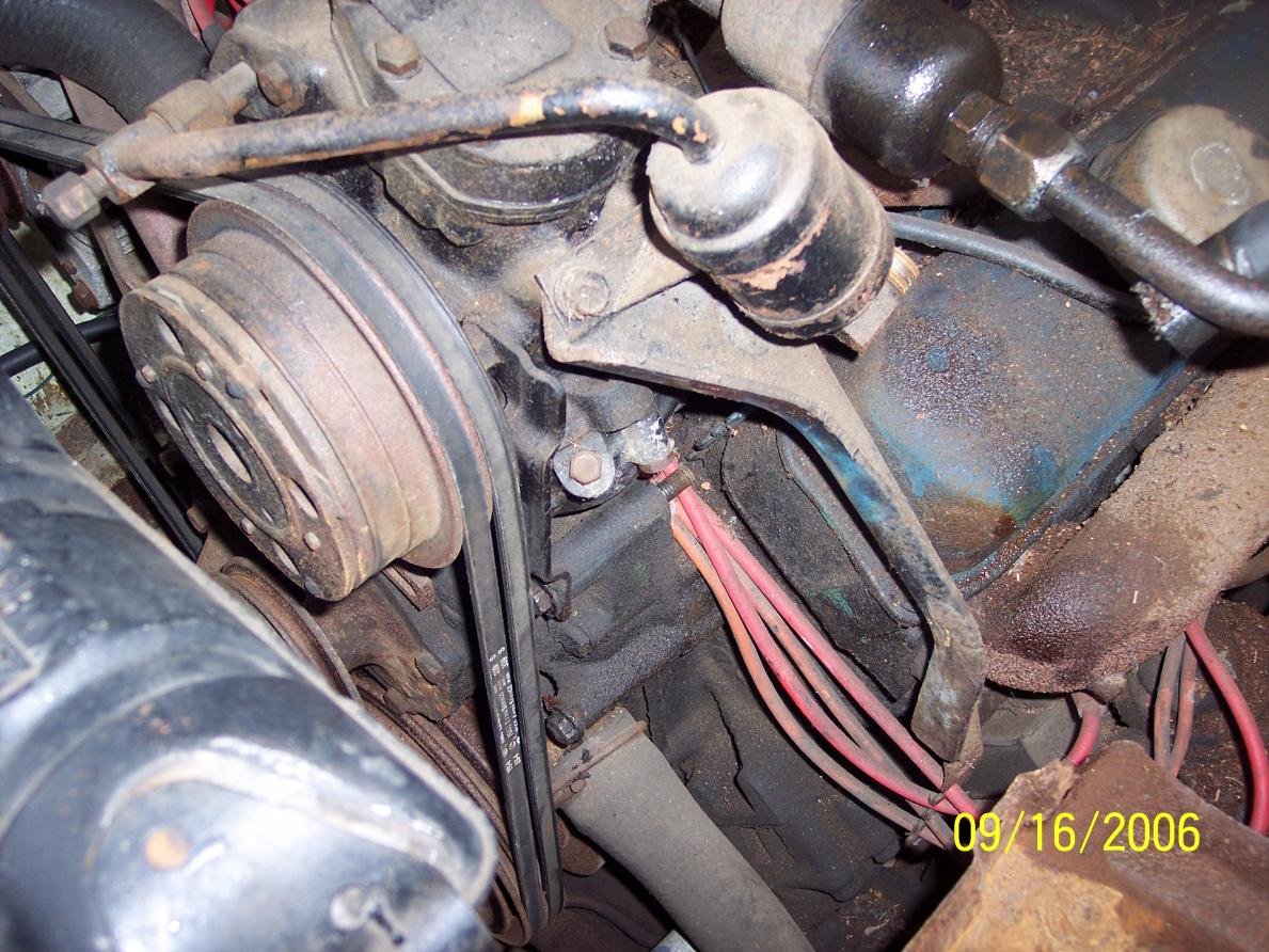

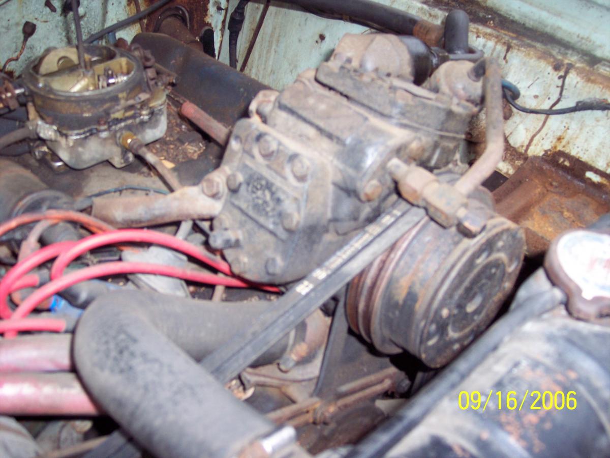

I am trying to hook up all the belts, and I have an idler tensioner and don't know where it get's bolted to. Could someone post pics of how they have their idler bolted and how the belts are routed? Thanks For B Bodies!
a/c pics
These pictures are of a 64 dodge 383 2 br carb.
2 belts run the a/c and the alternator as you can see in the pictures.
There is a spacer that is behind the idler pulley as you can see in the picture.
The other 2 belts run 1 runs the waterpump and the other runs the power steering.
The 440 belts are run the same way.
