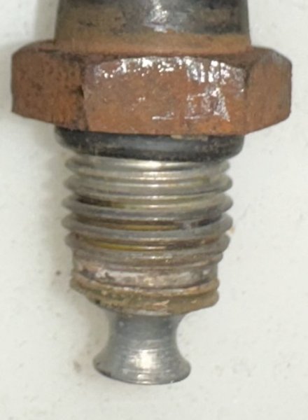

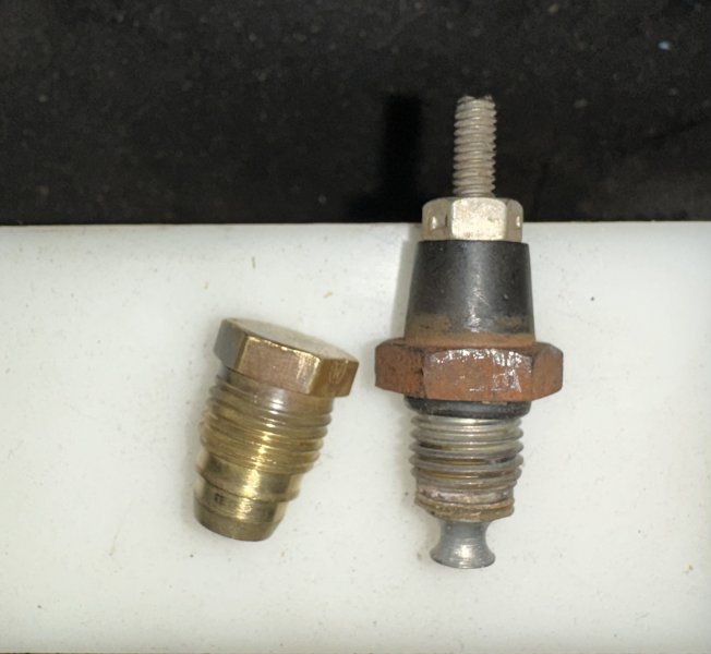

I gutted mind for that same reason you’re having, my brakes work 100%. I replaced the O-ring on the brake switch, nothing else inside.

2) The brake switch isn't designed to handle pressure, it is intended that the detent ball fit in the groove in the spool valve, if the spool moves off center the detent ball will trigger a light on the dash... Point of all this? The switch shouldn't see pressure...
If you want to eliminate the proportioning valve get a couple brass coupler fittings & connect the lines with the valve removed..

The brake switch has more threads with a “O” ring than the end plug.

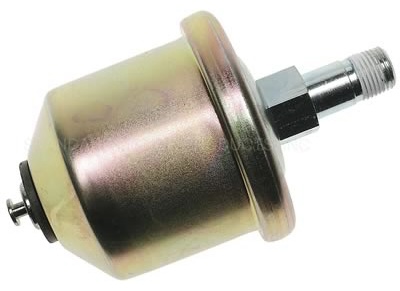

It's not the threads that fail, it's the plastic switch body.... Remember brake pressure can spike to upwards of 1500 PSI in a panic stop situation... Plastic pressure switches are fine for engine oil pressure @60 PSI but.....
I don’t know about your brake switch, mines all metal inside. It’s a contact switch, it’s metal. The plastic, which is on the outside is an insulator. Check out the metal threads, I don’t know what brake switch you have that has plastic threads or insides, mines all metal.
If I was you, I would replace your plastic switch body.
