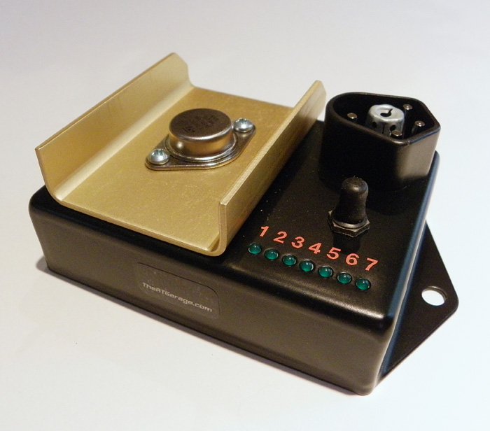

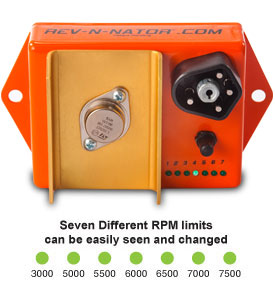

  • Chrysler Electronic Ignition CEI-ICU #1 Rev-N-Nator www.thertgarage.com.jpg
