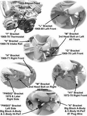

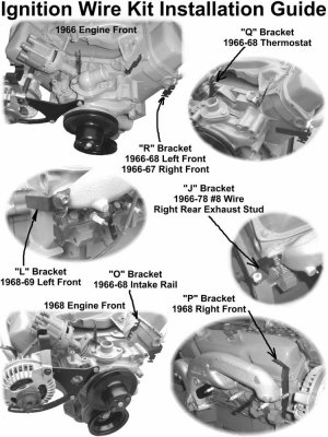

Where do all these (8) darn spark plug wire brackets go on a 69 383. My wires look like crap without them, but dont know where all there suppose to go..
look on herbs mopar site they list each seperately in the parts and tell where they go
Take a look at these photos
