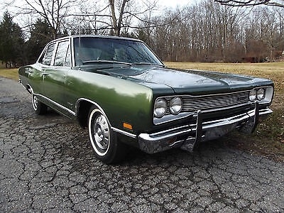

Hello folks, Im new to fbbo and I'm already in need of some help. I'm sure it has been covered before many times, but here it goes, I just bought a 69 coronet 440 4dr and I'm in need of tires. It currently has 7.75-14 bias ply. I would like to change to radials and possibly change wheel size. Any advice would be greatly appreciated. Such as tire size and brand recommendations. Also should I keep the original wheel size or change it? Thank you in advance.

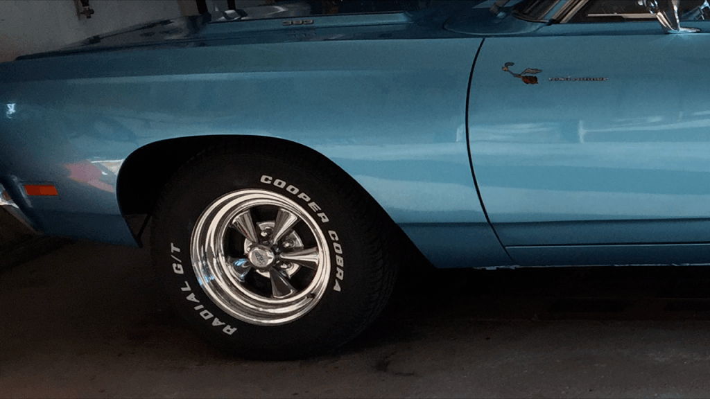

I just put a set of Cooper Cobras on my '69 Road Runner after a BF Goodrich T/A Radial separated a belt on me. Happy with the Cooper so far. No more Goodrich for me.

I like the Coopers too. Inexpensive. Got these mounted, balanced, to the door from Summit.

Your car looks great with the whitewalls and caps! I was running 225-70 14's until I shoved the 295-50 15's on the rear. Not sure about 4 doors. Yours looks kind of classic elegance and I would not go for a muscle stance if mine.
I agree with Dennis. Your car has a classic clean look. Why distract from it by putting muscle car looking tires on it. Looks great the way it is.
I doubt you will run into problems with tire sizes fitting in the wheel wells until you exceed something like 10-11 inches wide and about 28 inches tall (rear) and that about 8 -9 inches wide and 27 inches tall (front). How you get to these sizes (rim + tire) will not be with the stock rims you have, but can be done with a variety of different rim sizes (15, 16, 17, 18). I like the look you have now but there are not too many options with your current rims. When I used the stock rims like yours, I ran 215 75r14. The car originally had g7814. If you decide to change rims, there are many companies that make them.
