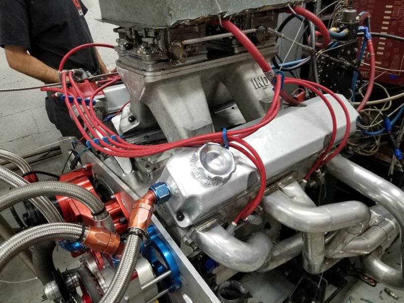

Wasn't aware anyone was banned. Not sure how to take your post, but yes, i had the T ram running great first season. Cold engine, one pump, hit the button, fires up and idles. Warm engine, no pump, hit the button, starts and idles. Does not go rich once warmed up. Can idle all day and not load up. Can drive most any where and still run 10.06@134. Manny old wife's tales about T rams not being street able, all false. These things are better than a throttle body fuel injection any day. You have to start with good clean carbs. Wanted to put this out there for anyone wanting a T ram on the street, but hearing all the BS stories that they cant be used on the street. I have vids to prove all of this if anyone is interested.

Yes, 511, magna fuel 300 matching regulator, all -10 hose accept reg to carb it -6. Enderle linkage, BLP billet 650's. I think they are 1 11/16 blades with 1.320 venturi. I would have to ask Dom@ThumperCarbs to be sure. I have a pair of his BLP billet 950's for my 572 Hemi that i would like to try on my 511. Seems like t rams like too big carbs.

My combo has been great for drivability haven't hardly turned any wrenches on the carburetors since it was on the dyno years ago now.

Only thing i can say to that is the Indy t ram is very heavy and with both carbs plus linkage is probably around 40#. I have been told the T ram also like a bit different setup for racing, like higher stall verts and low gears. Back in the day when these t rams came on the scene, 4 speeds and low gears were the rage. The only negative on these t rams that i see is weight and expense.
