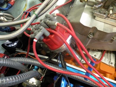

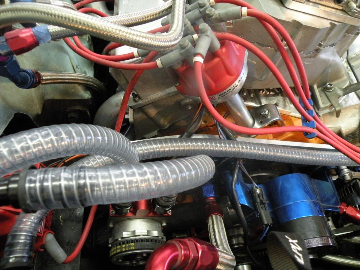

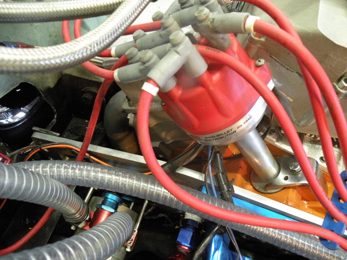

Heres a few pics. to help you out.
Note the position of the screws on the dist. cap. Yours probably have those little tabs with allen bolts. It should not effect you in any way if you line it up in this manner. I use to have the same dist. as yours.

That does help. My distributor was installed with the cap hold downs turned even more to the left than yours. The intake hits the cap dead in the middle of that bulge. I need to reset my TDC and clock the distributor like yours so I will have some room to adv./retard my time if needed. Maybe this pic will show it.
