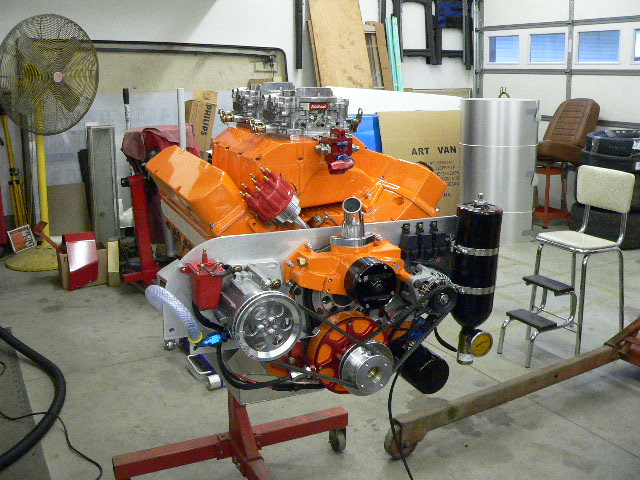

Assuming big block Indys. Are there oil lines coming from the rear oil galley to the heads? Are there 1/8" pipe plugs in the front of the heads (you can see it on the drivers side head). If not I would bet not. I bondoed the ends of mine where the Indy logo is cast.

Wow DVW, that is quite the intake you have on your 426! Is that a street tunnel ram with a 2-4 barrel top? I'll bet that makes some big horsepower. What kind of 1/4 mile ETs are you getting with that one? Have you dynoed the motor? Would like to know how well it runs with that intake and the Indy heads.

The motor is 572". 14.8-1, .800" roller. The intake is an Indy Cross Ram. Never been on the dyno. It's in a 64 Belvedere. 9.25@147.
