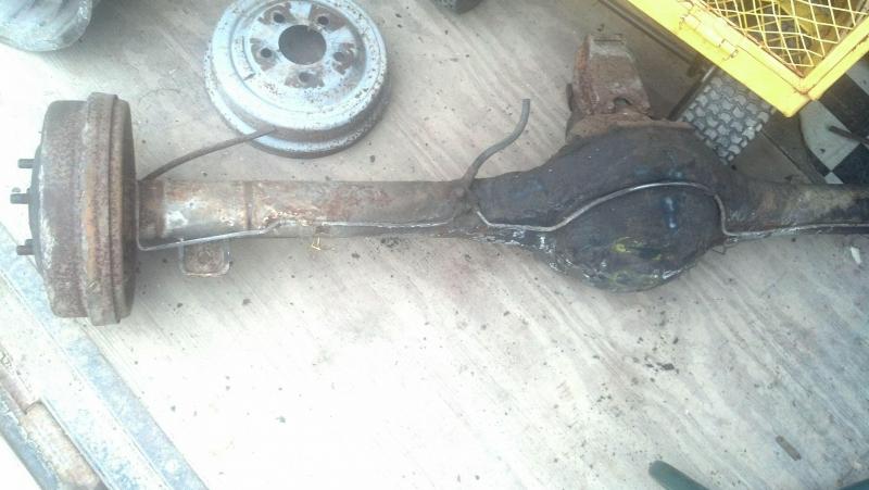

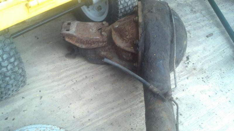

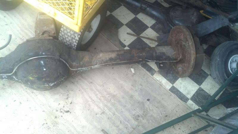

rearend 1.jpgrearend 2.jpgrearend 3.jpg so here are the pics of the rear end that the guy wants 700 bucks for with the leaf springs and the sway bar. It looks pretty crusty what do you guys think he just sent the pics

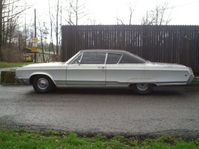

68 Chrysler Newport.jpg so I found this its not a 440 but it is a 383 it is a 68 Chrysler Newport does anyone know anything about these and if the drive train would be compatible they are asking 1500 obo would feel bad robbing it for parts though I could put my small block in and cruise it around.

Sounds like he doesn't have another buyer for the rear. Offer him $500 and you will have cash money waiting for him at the meet up place on Sunday.If he says no to that, tell him to call you when he will sell it for $500, also let him know that if you find another rear that you will buy the other. He will know he has the money on Sunday.
