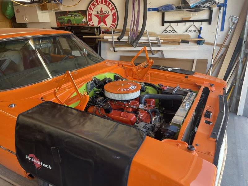

Looks like everything is new under there.
I like to drive it for a week or two without the hood.
So much easier to check for leaks and re-torque stuff.
(And it's kinda cool)
