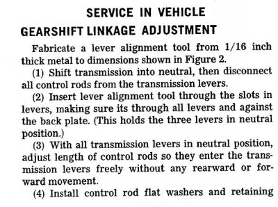

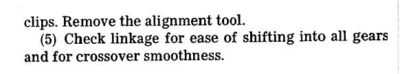

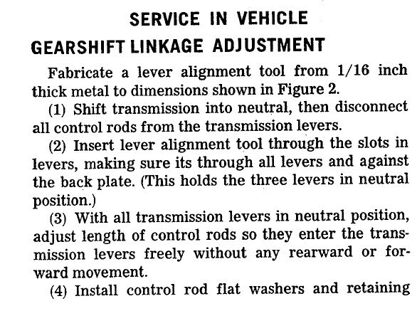

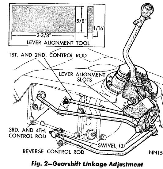

Some things that ARE important is
did you align the shifter body as I mentioned, using a bolt through the alignment hole, so that the body is IN NEUTRAL when you hook up the rods?
Are the bushings/ rods/ levers tight with very little / no play?
Remove the linkage and shift the levers on the gearbox by hand, and "feel" for if the detent mechanism is tight, and locks out the other lever.
Do this by moving first the forward lever forward, and then aft, and each time, ATTEMPT to move the rear lever. It should move a tiny bit and "stop" against the detent, and there should be a decided, firm, obvious "snap" when shifting the lever to each position.
Do the same to the rear lever, and test the front lever for lockout.
