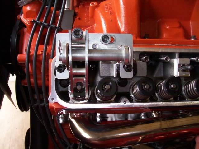

I did on my solid flat tappet as its just a little help with less spring pressure when breaking in the cam. I bought this valve spring tool from Mancini and it works very good and makes the job easier then any other tool I have used. Ron
Nice tool Ron!
Nice tool Ron!
Yea it is nice. What I like about it is that you run the allen head bolt in and it compresses the valve spring and holds it there until you back it out. So you can use both hands getting the keepers in and out. You dont have to use one hand to hold the tool like other tools. Ron
