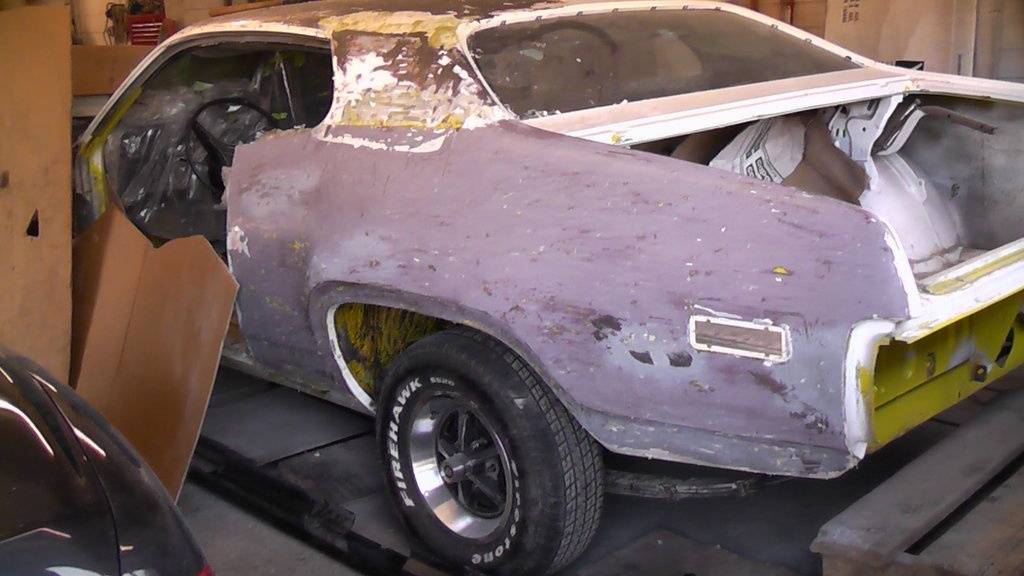

The 71 is at the body shop,it will get base coat/ clear coat, and be in a down draft,and get bake,how soon can the strobe stripe be installed.It should be back by October 1.This is the stage its at now.
45 days to cure your paint, then add your stripes. It may be less for a paint job that was cured, but do you want to take that chance?
Thanks Kelly,one would think the car being bake would cure all.
I would wait as long as possible; it's the end of the season, no need to rush it..........I assume the paint will be sanded and buffed?
give the area another quick cut/buff just before installation......
I waited about a month and a half or so when I did my Duster stripes. Can't hurt to wait and not rush it and end up redoing it. Plus your really rubbing on the finish when you have to move a decal or even worse peel it and yank on the fresh paint.
