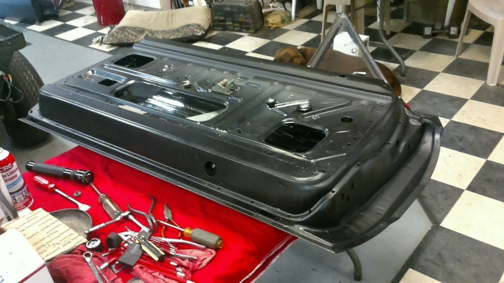

I just did this on my 68 GTS Dart. I have done several Mopar windows before. A,B,E bodies. On the A and B body cars. I put in the rear window track first. I assemble the wing vent assy and the roll down window together, because of the fuzzy slide at the front of the window. I leave the door inner and outer seals off. I install the wing and window as an assy. without the regulator ( sometimes takes an assistant ). I then move the window down about half way and install the regulator. Yes.. There is room to do this. I install the inner and outer seals last. Hope this helps....:D:D

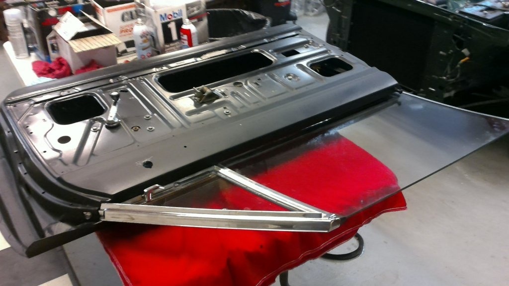

Just did these today... No Window wipes yet....

More cluttered now , than I would like... Too many Projects...68 GTS, 70 Cuda, 65 Belvedere Post Car. The vent window rubbers are pretty easy. There is a screw at the top that separates the A . Then there is a clamp at the bottom that holds a swivel post. and then of course the the top swivel, which is just a screw. The new rubbers go in pretty easy.
